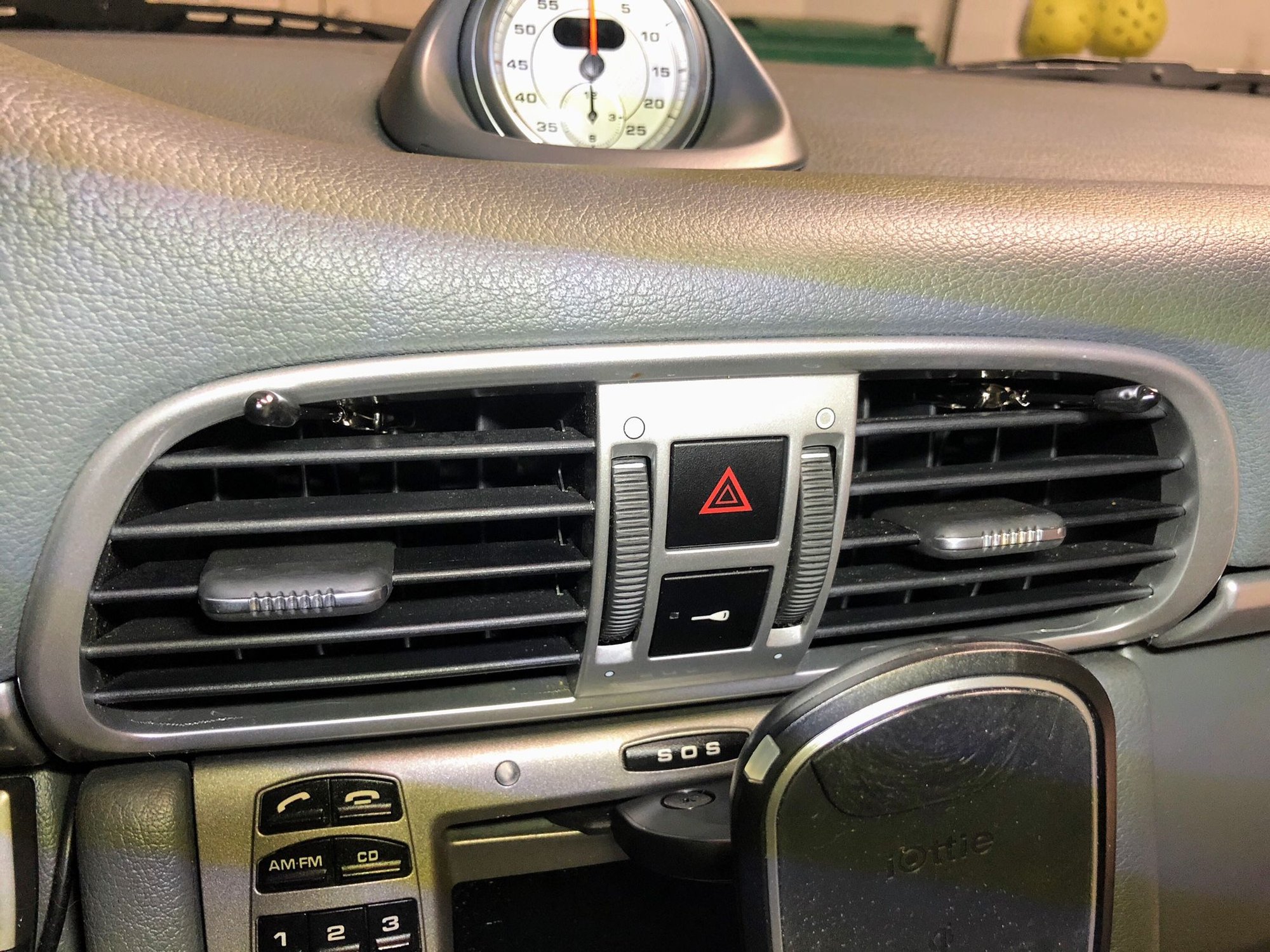

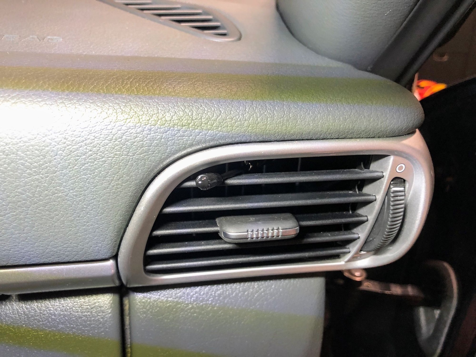

Here’s a decent inexpensive fix for a 997 with broken AC vent direction levers (left/right).

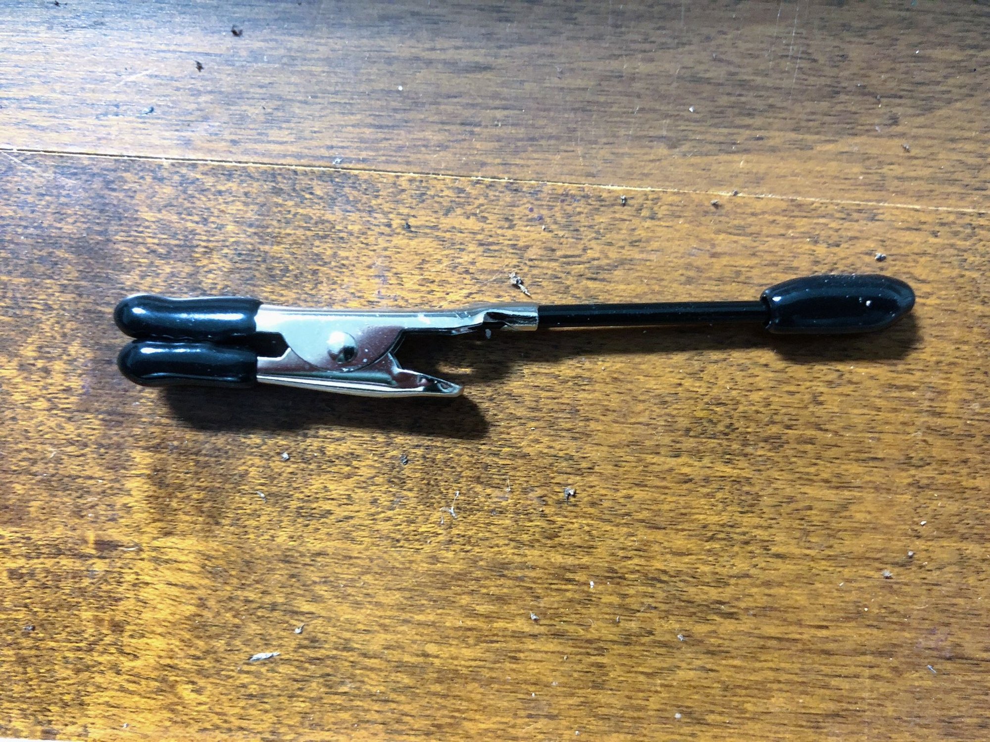

Made a little clip to attach to the left/right fins for easy adjustment.
Got this on Amazon for $12, cut the posts, and used the rubber protectors on the ends.
Clipped it towards the top of the vent.
The post is cut short enough so the tip is all that sticks out. Just point it left/right where you need the air. This doesn’t restrict the up/down that much. Still very usable.
Isn’t an eyesore and looks decent for $12 and 20 minutes.
