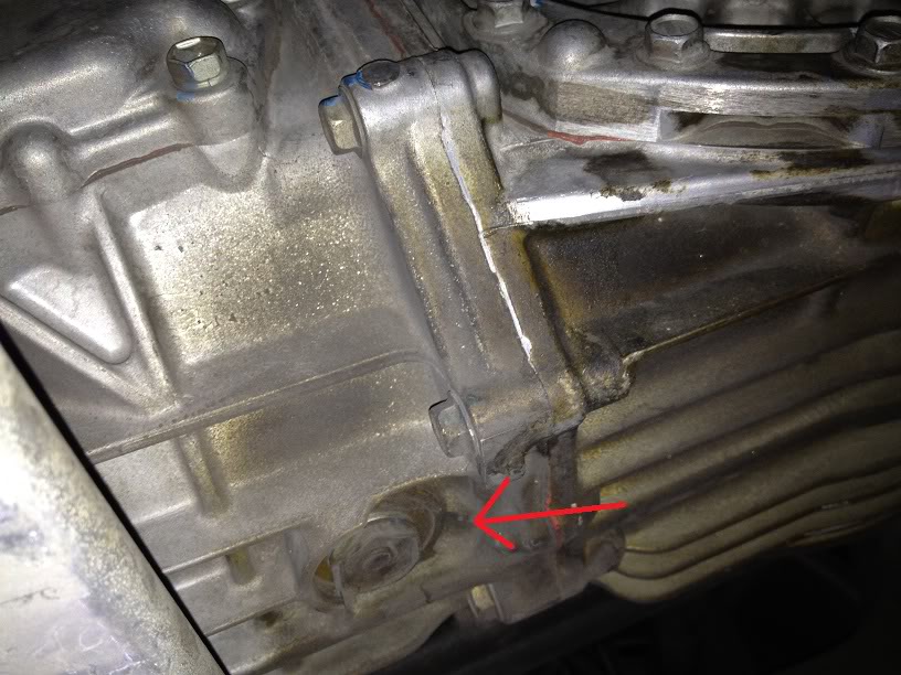

I am thinking this is the drain plug. It's on the bottom of the transmission.

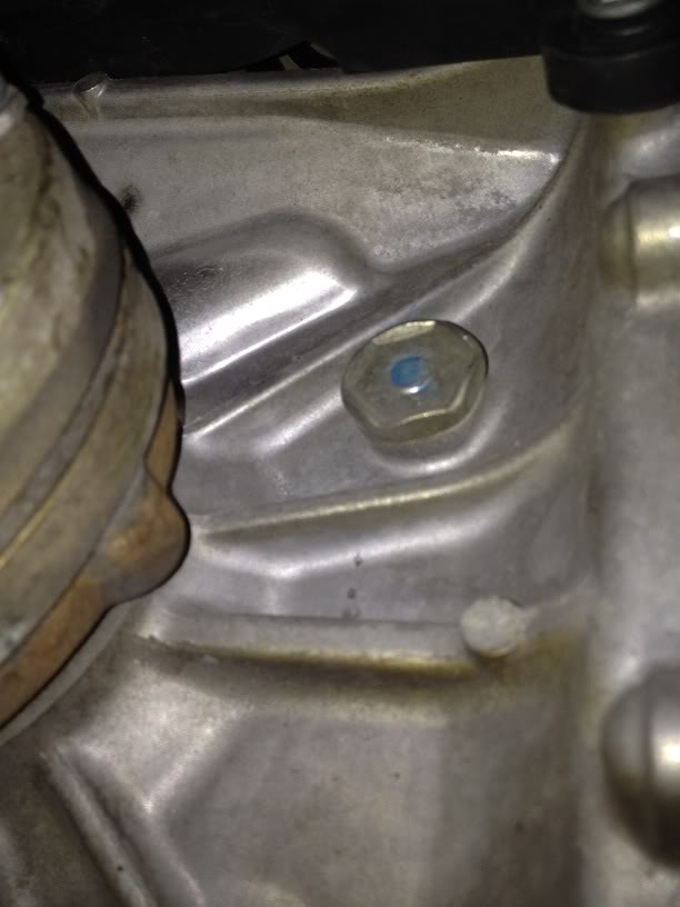

So would this be the fill plug? It's about halfway up on the transmission (passenger side). I am confused because it looked like other DIY's online showed the fill plug to be on drivers side.

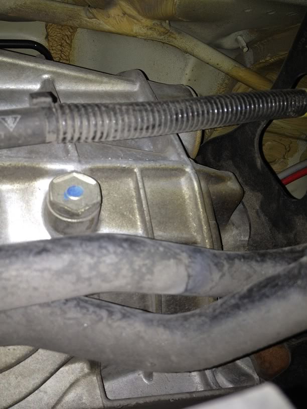

I also noticed another thing, up higher by the axle (passenger side). What is this plug for?

In my experience with MTs (but not 911s), there will typically be 3 plugs for the tranismission fluid drain/fill procedure.
The bottom is obviously the drain plug, the top is the fill plug where oil is entered into the tranny case and the middle plug is a "full" plug. With this plug removed, fill the transmission with fluid from the top orifice until oil your new fluid comes out of this outlet. It's full. Reinsall the plugs and you're all set.

Oupsssss! You are ABSOLUTELY right, I was thinking about the clutch slave cylinder.
b2sc is correct, the middle is the "full plug".

remember to remove the fill plugs before removing the drain plug.
