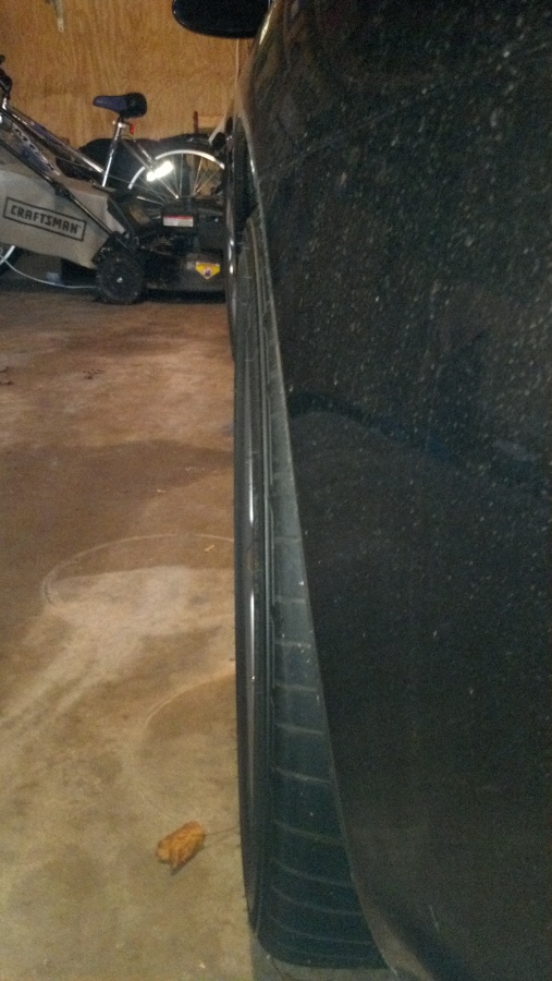

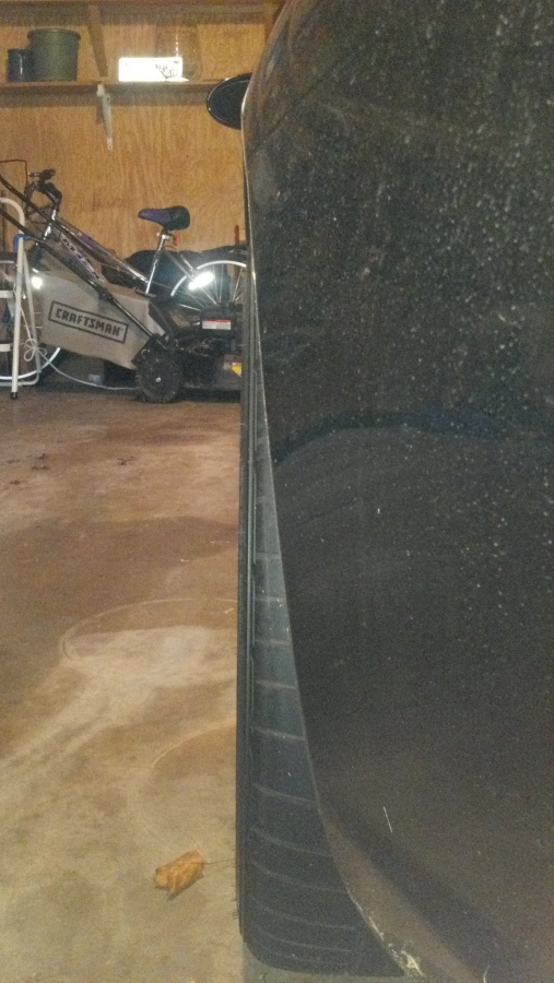

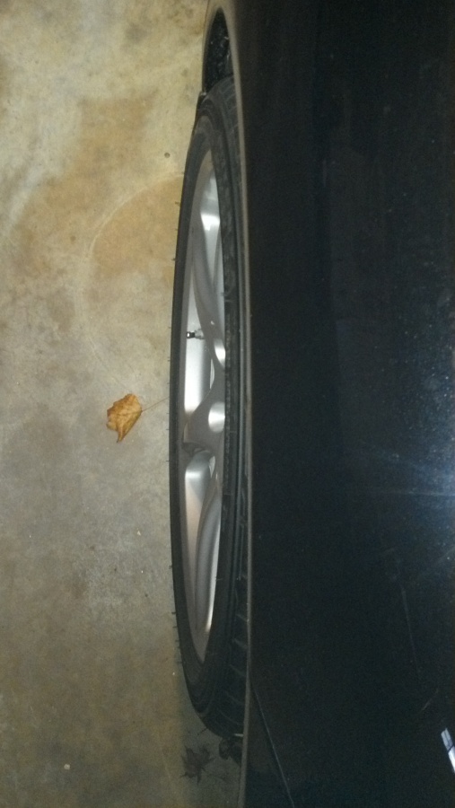

I have Mich SS 305 30 19's with 5mm spacers on a C2S and the edge of the tire matches perfectly with the fenders's outer edge. Also added 5mm's to the front. All fit perfectly and greatly enhances the aggressive stance.
Hmmm.....interesting...... I was at the dealer yesterday and they had a C2 cab with 305s and the tires stuck out past the wheel well a bit (maybe .25"). I think they were Brigestone's. The wheels had also been switched with another 911. Probably the switch in wheels is responsible??

I have the same setup -- 305s with 5mm spacers. Because the wheel well is flared, the edge of the tire is not flush with the entire wheel well.
The pics are helpful, thank you!
