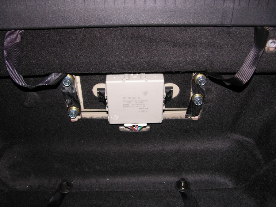

There is a control unit, part # 997 618 321 02, at the location below behind the air compressor and tire goop panel. At least this is where they put it on my 09 C2

Well, there you go.. that means you also need the wiring harness for that to and from the lights and rest of car... now its starting to look way more expensive and complex to add on. Doable, but not a drop in easy-peasy task.
