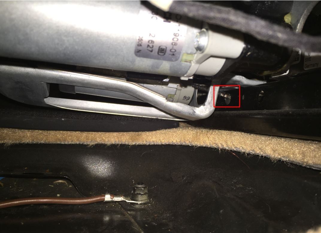

Originally Posted by Tarek307
are you talking about the 2nd image, describing that thing with the yellow wires? you unplugged it and plugged back in and it worked? did you have to take the seat out?
It's the red highlighted shaft. The end of it that is worn out and is supposed to be completely plugged in that hole is bent and in clear sight.
By plugging that in, the seat worked again.
