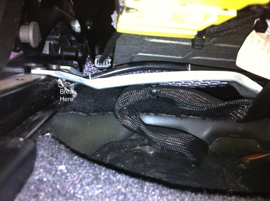

Just yesterday, my passenger side power seat quit properly going forward and backward on the rail. What appears to be happening is that the side closest to the driver is moving on the rail, but the other side isn't, which makes it cant side to side. The seat back angle still adjusts fine.
Any ideas? Thanks.
EDIT: I've discovered the problem. There appears to be something broken-- perhaps a bolt that is encased in the long black tube. Anyone seen this before and is it something that I can fix myself? I've attached a picture of what I think is the problem.

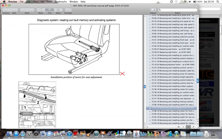

Is this the part?

I'm having a hard time telling for sure from that diagram. There is a black tubular shaped thing that runs in the groove of that cross bracket that appears to be broken on the exterior side of the seat. I can't imagine it would be too hard to fix if I just had the part and could take the seat out.

exact thing happened to me, and dealership ordered new track and repaired under warranty.

Well, I'm out of warranty so was hoping to do it myself or at least get a sense of what my local independent could do it for.

I think I have the part identified and would like to attempt this repair myself. Any clues on seat removal?

You've got 4 bolts and I believe 2 connectors that need to be removed/disconnected. Try to get the seat as close to centered on the rails as possible. This will make getting the seat in and out easier. Use towels or blankets to protect the console and door sills. The seats are a bit heavy and awkward to remove. If you can, get a helper.

Seat cable snapped
Hi I just bought a 997s with the same issue, I took the seat out and worked out it was the cable, but the end of the cable is still in the slider mechanism and I can't ge it out . How did you fix yours ? Also where did you buy your replacement parts ?

I brought it to my local independent mechanic and he ordered and installed the new cable. I can't remember the exact cost, because it was awhile ago, but it wasn't outrageous at all-- under $300 total.
