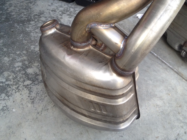

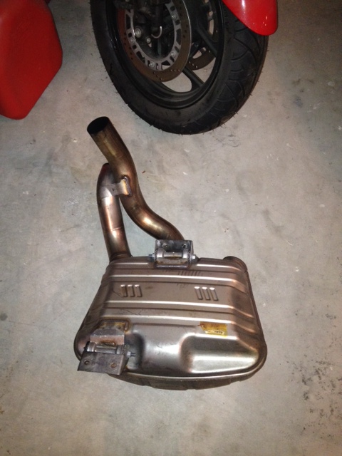

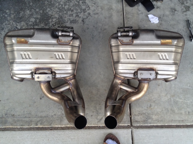

Before and after of the cans. Now that's what a weld bead should look like. Good luck. PM me with any questions. Be happy to help.
Your weld job looks like one of the best I've seen w/ respect to the 'Gundo Hack'. Most look like they've been done by 1st year auto shop students.
Very Nice . . . .
Very Nice . . . .
I went to a motorcycle builder instead of a muffler shop. This guy does a lot of work for me for my mfg business so I was confident in his quality. You are right. Some of the pics I have seen shows low quality welds. Probably wasn't preheated b4 the actual weld.

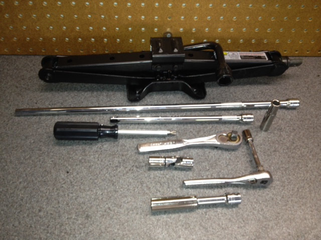

It's DONE!! And music to my ears!! Shoulda effen dun dis waaaay sooner. Wish I know how to post videos but here's my current set up. Gundo Hack on both left and right mufflers and Fabspeed Xpipe for the center bypass. (don't know why I said "both left and right" cuz why would anyone only do one side? ) Let me share some of my findings. I had a hard time finding DYI for the 997.2 (plenty of useful info for the 997.1 as the principal are similiar), it's probably out there, I just didn't see it so I decided to create a DYI for us 997.2 folks that want to tackle it themselves.
Tools you'll need:
20 inch long 3/8 drive extension
10 inch long 3/8 drive extension
3 inch long 3/8 drive extension
10mm deep socket (3/8 drive)
1/2 inch deep socket (3/8 drive)
1/2 inch short socket (3/8 drive)
3/8 drive ratchet
3/8 inch flex coupler
T–30 torx screwdriver
3/8 inch socket (12 points, 1/4 drive)
3 inch long 1/4 drive extension
1/4 drive ratchet
Screw jack
Attachment 173494
