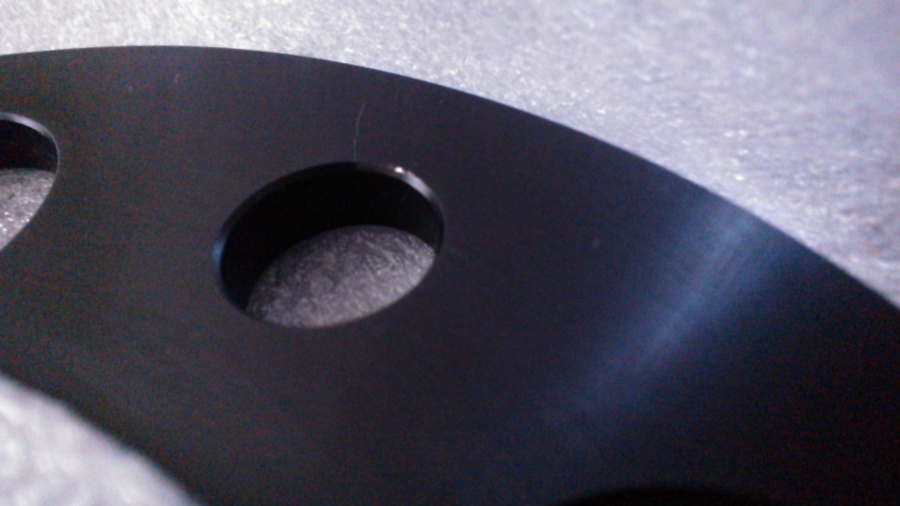

1) I noticed that there were a few spacers that had the black part scratched off. would this affect the performance or reliability of the spacer? it's minor, so picture is attached:

The screws you mention keep the spacer attached to the hub. They aren't necessary but they are convenient. Without them you'll need to adjust the hole locations. The locating pin will take care of most of that issue.

Thanks for the informative answer, Alan!
Any feedback on the minor 'scratch'? I assume this is normal...?

It won't hurt the part. It is more of a cosmetic issue. If it were me I would touch it up with some paint.

You're not going to see it anyway - the wheel covers it...and after putting the wheels on and off a couple of times it will get that "aged" look anyway.

Wolf, thanks for purchasing our wheel spacers through Suncoast. Sorry to hear you have what looks to be a very small scratch on the black spacer. This will not effect fitment or performance in any way but feel free to contact me directly or the good folks at Suncoast if you would like a replacement kit, no problem.

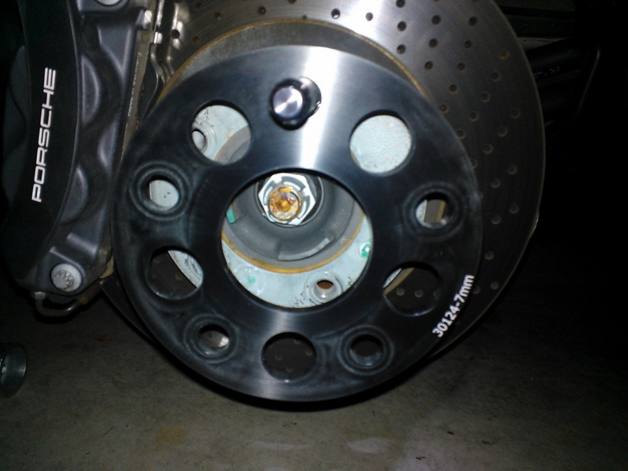

looks great! The only confusion i had was if the "lip" faces outwards for the 7mm spacer, but i think i did it correctly (spacer1.jpg correct, spacer2.jpg incorrect).
It was a more pronouned lip for the 15mm spacer and it fit perfectly in the wheel, which made it more obvious.

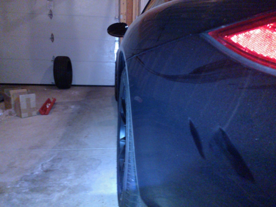

some terrible pics attached.

3) I also remember hearing about hubcentric spacers. I notice that the 15mm spacer has a "lip", but the 7mm does not. does this have anything to do with hubcentric.
I have 7mm up front, 15mm in the rear. Started with H&R spacers. The rear has the lip, the front did not. Felt vibrations in the steering wheel at highway speeds. The problem was the absence of a lip on the front spacers along with Porsche washer style lug bolts. Too much slop in mounting the front wheels to the hub caused off center balance issues (lobster fork style wheels).
Tried an eBay brand spacer without a lip - fail.
Switched to aftermarket one-piece lug bolts - helped a ton, still had some vibration at high speed.
Finally fixed with Brey-Krause brand 7mm spacers with a lip. Here's the original thread: https://www.6speedonline.com/forums/...c-spacers.html
You can check the "slop" by removing the Porsche cap from the wheel while attaching the wheel. Visually inspect how much play exists between the wheel and the hub before installing lug bolts.
