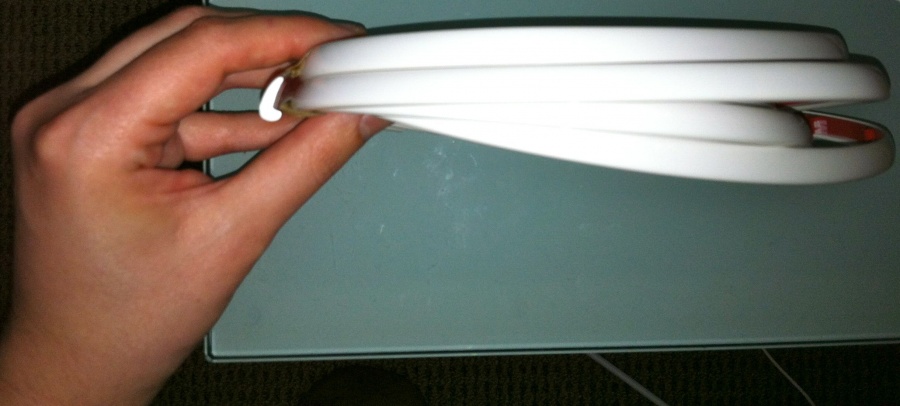

Awesome update, Doug! I guess I got hosed paying $100 for just two applications (but, hey, I got it installed).
I've attached a photo of what it looks like (in white) so people can get a sense of the sort of material it is. The red on the inside is backing for the adhesive strip.
Keep us posted and, please, pics!
EDIT: Just looked on the Dawn Enterprises website and you should make sure you ordered the version with the 3M adhesive (at least, that's the version I have - not sure how the other stuff adheres). The good news is that it comes in more manageable 16 foot rolls! Looks like that is DGAR.
