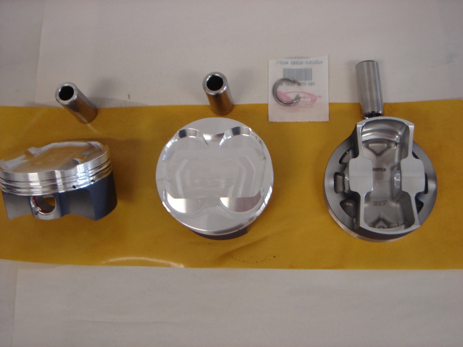

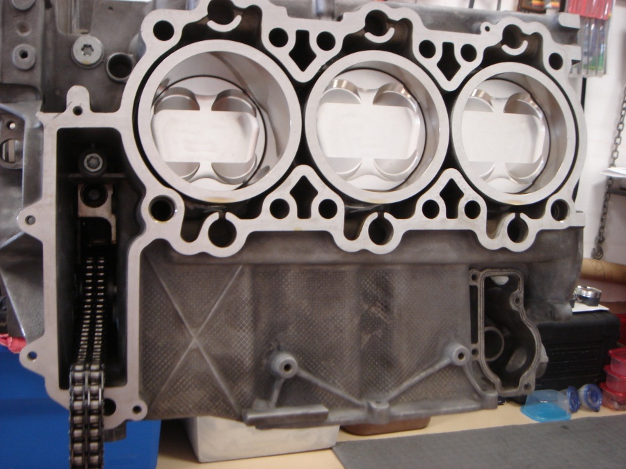

Originally Posted by Pavel_Engines
Do you have more detailed information regarding their sleeve job? Do they cut out the old sleeve, press in a new sleeve, and recoat it with nekasil/equivalent; or do they bore out the sleeve and press in steel liners?
LN bores out the case for their billet aluminum sleeves with Nickasil coating, presses them in place, then mills the deck. They also supply JE pistons, pins & rings made for this application. All this cost approx. $4,300 with shipping. Go to LN website for more pics.
Here's 1 of the pistons:
Called LNE today and discussed the situation. They quoted me $3,800 with a shop discount. Can't seems to make reason of any of these prices they provide. I had CP Pistons make custom pistons for a 2009 Jaguar XF supercharged and 2009 Aston Martin Vantage V8 I recently rebuilt. Both cases pistons cost $1,600 for full set including rings, pins, and locks. That was the price for 8 pistons. Making 6 pistons will be even cheaper, about $1200. If LNE has JE make pistons in higher quantity than 1 set, then the price will be even cheaper. So if pistons cost $1200, that leaves $2600 for labor and new sleeves. I dont know how much those sleeves cost but I sleeved aluminum Nissan 4 cylinder engine for about $650 in labor. Sleeving a 6 cylinder block should cost about $1000. Unless they bore, hone, deck mill, and align hone mains all for that price, then it doesn't add up.
LNE said the block cannot be sleeved with steel liners. No real explanation why but apparently "it will never work with a Porsche" was the explanation. There are plenty of aluminum block/steel liner motors out there, Chevy LS1/2/6/7, Subaru 2.0 and 2.5, just about every Nissan. We'll see I guess.
