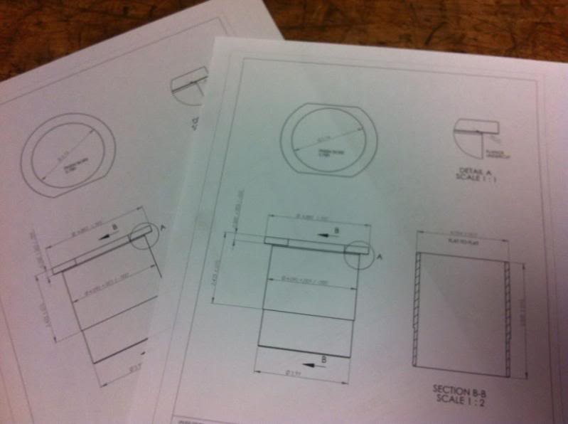

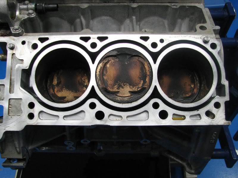

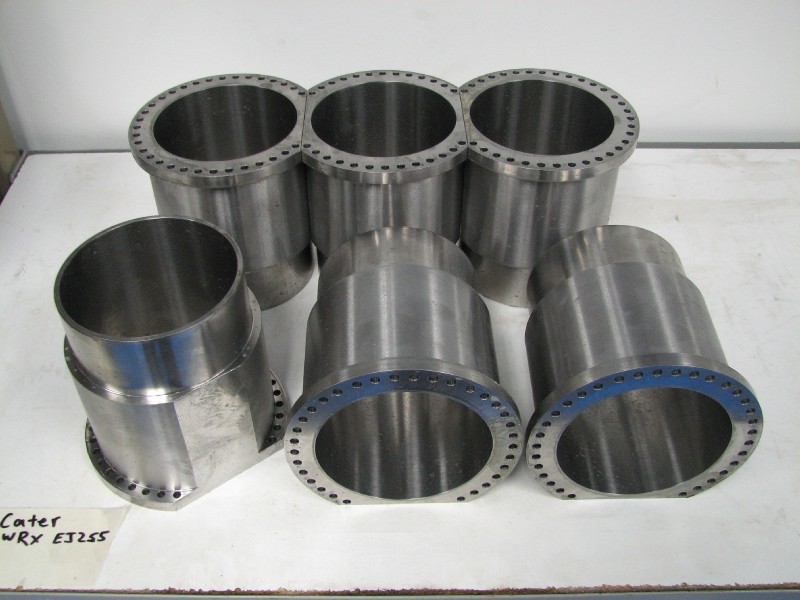

Originally Posted by BiteEmNBeatEm
LN does great work and your not just paying $3800 for liners, they have done a great deal of R&D and got rebuilding the cylinders to a science. Now steel liners do not tend to work out because all you end up doing is boring out part of the aluminum cylinders and then press in a thin iron/steel liner and can possibly sink or due to expansion crack the block. I personally went with complete steel cylinders not liners so we punched out the entire aluminum cylinders an then replace with iron ductile cylinders that are seated into the block and supported at the deck as well with a semi closed deck but my build is for a custom built turbo application.
My engine is being built by Jason over at UFO Motorsports in LongBeach CA but I have done business with Don over at EBS and he is also a stand up guy that knows his stuff.
PM me if you need any of there contact numbers. Hopefully you can get back on the road in no time ...
This is exactly how I planned to do this Carrera S block.
This is how I recently did V6 sleeves for an open deck motor. I designed the sleeves and had them manufactured.
open deck stock block
I have 2 spare Porsche case halves laying around; one from a 2001 Carrera 3.6 and other from a 2007 Carrera S 3.8. If I have time in the near future I might do some machining and try sleeving them.
