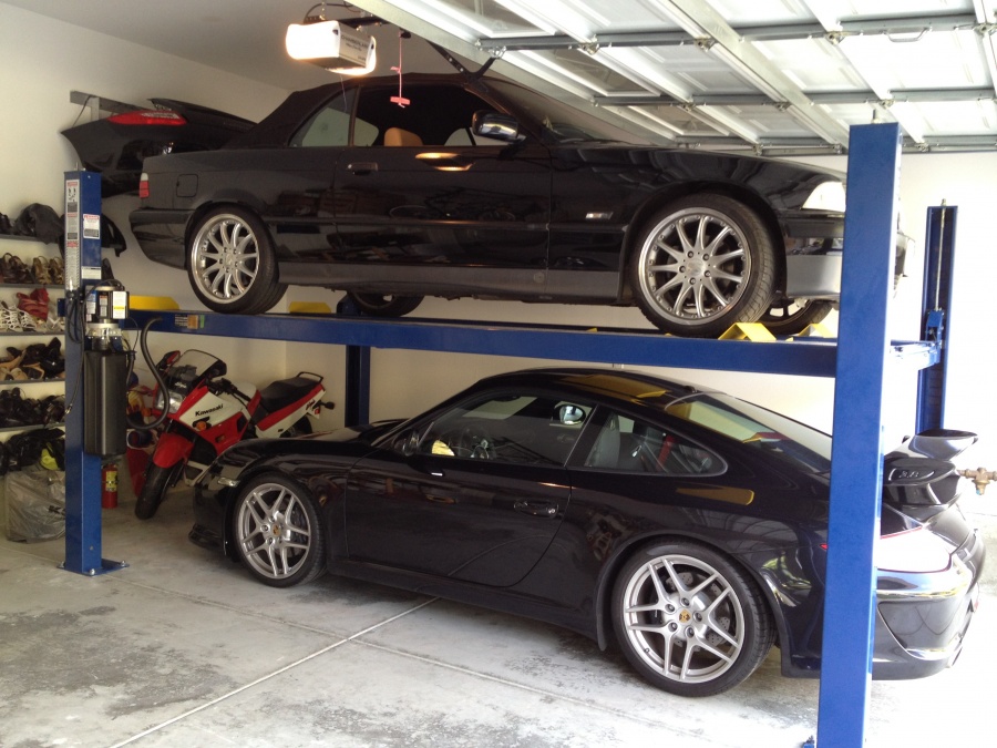

So here's the final product for those that may be interested. Very happy with it so far. Had to spend 5 hours in the 100 degree garage to modify the door up 5 inches to clear the stack. At least I didn't have to change the opener to the jackscrew type. Attaching a pic taken from my phone. Hope it works.

Originally Posted by slick911
I only needed 2 inches to make the stack work so I just tilted the track up. Never worked with garage doors before but figured it was worth a shot. If I mess it up then I could hire someone to move the whole track up toward the ceiling. Fortunately it worked out. I drew it up in autocad and was able to plan ahead on how much track to cut from the front pivot end. If u r planning to tackle this task, I can provide u with some pointers based on what I encountered.
LOL, sounds like we have an engineer. Personally, I would have had it lifted, it almost looks too tight, as you had to back in the BMW and the lift is only half way up. I'd image trying to work on the car would be a night with a lift half way up. My back hurts just from looking at that!!! Unless it's simply storage, then looks like you're good!
Yes. Simply for storage. I know what you mean though. Will probably change it up when I start doing more work on the cars.

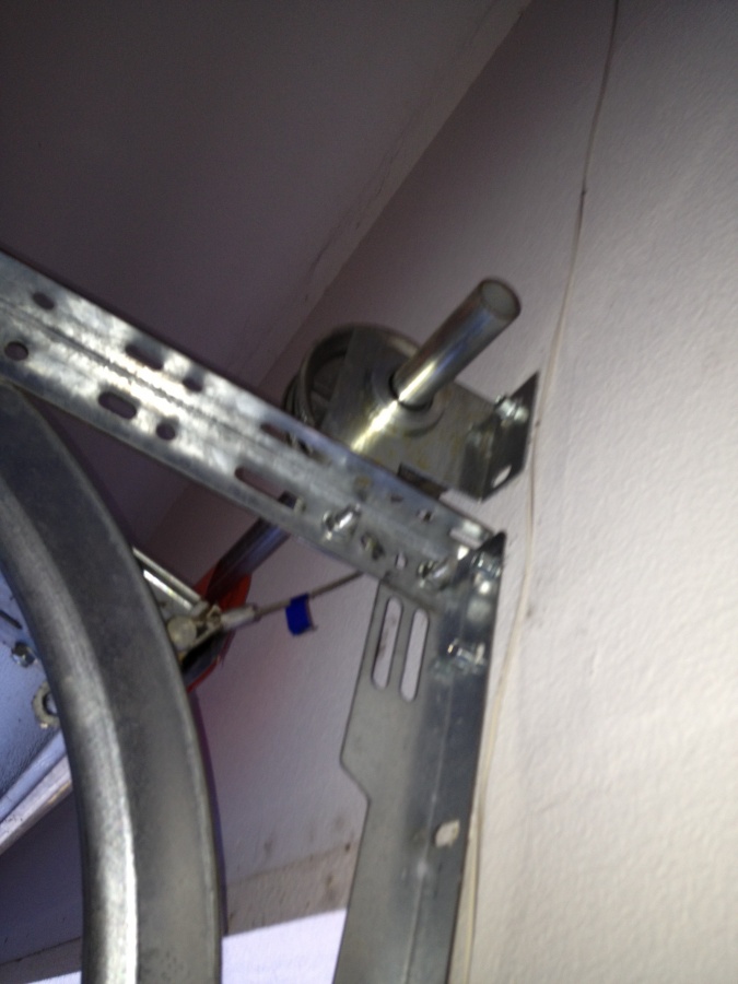

Here are some pics of what I modified.
This one shows the the top end of the door lifted five inches (or five holes). It was mounted in the first hole from the bottom. Will probably use a tennis ball to cover the sharp ends.

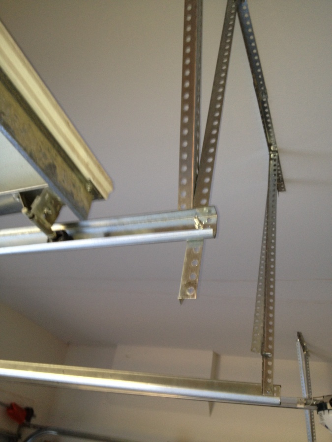

Old Aug 21, 2012 | 06:30 PM

The horizontal bar is the one I have to cut off 3/4" from the end that bumps the wall. Luckily there were other holes I could use to bolt it back.

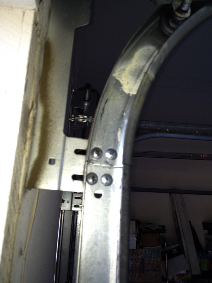

This pic shows the seam of the lower end of the arc (between the four bolts) where I had to file down a new angle so that it rests properly with the vertical track. Only had to do this to one side the other side a plenty if gap to accommodate the tilt. Didn't take a picture of the motor but that was moved up five inches too. Hope this helps.
