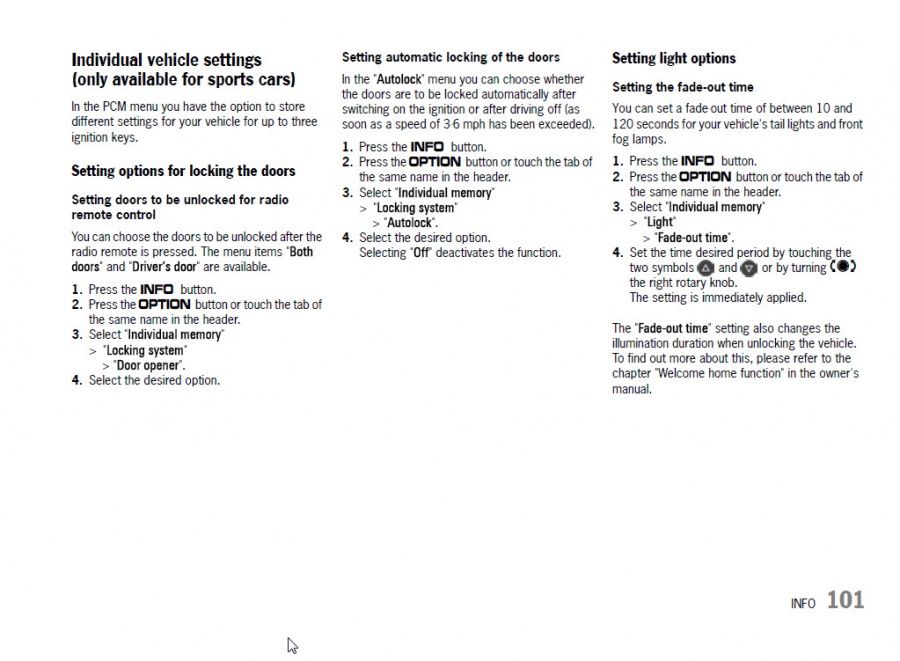

Just got a 2011 gts and have the first service appointment this week. Can they program the doors to lock when in motion or can I do that? What other things can they program?

If you have the sports chrono package, you can do it yourself. If not, the dealereship can do it for you.
If you want the sports mode without the timer features, it can be retrofitted. The list of features that can be adjusted with the retrofit depending on the options installed are listed in the link below

I do have the sports chrono package. How do I program?

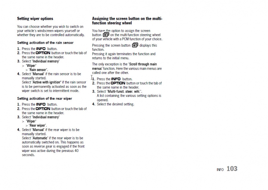

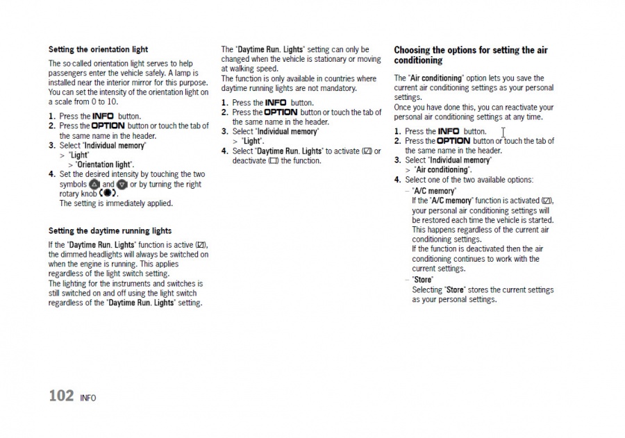

From the PCM3 Manual
