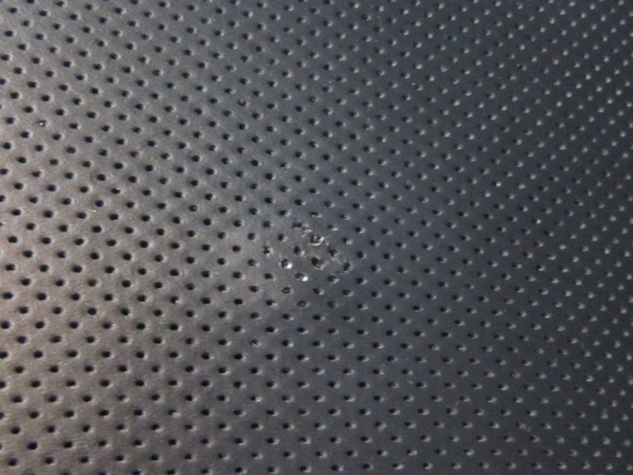

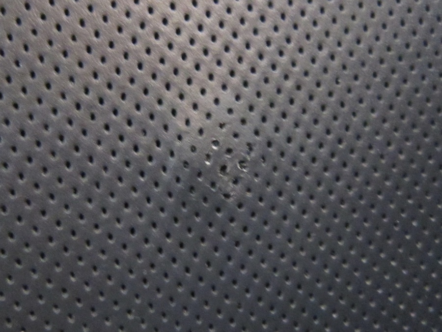

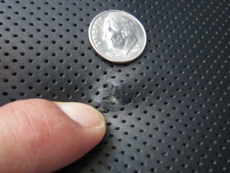

they can patch the leather with filler, spray dye over the section to hide it. it won't be 100% but close. it's usually about $100-200 for repairs.
Thanks again djant' for all the input and advice on the leather repair- Tried this company and the steps and process were exactly as you described. $125 for the job.
Here are some before and after results to share with everyone. There's a slight bulge from the patch underneath (Jack did advise me of that) but better than the tear and potential to rip further. Overall I'm content with the work performed- If the puncture/ tear had been bigger the one concern I'd have with "perforated-vented" seats being repaired this way is that during the repair they use a filler material (as a patch underneath) and finishing spray (over the top of the sprayed dye) on the repair which would clog the vents. The surface over the repair does not feel as pliable/flexible and is slightly hard to the touch due to the filler/patch underneath and finishing spray.
In my case the damaged area was quite small (less than 1/4 a dime to scale) so these factors were insignificant regarding clogging the vents and harder texture of the repaired area. One might consider these variables if your leather tear is bigger.
Thanks everyone and dj!

glad it work out buddy! looks great! these mobile shops are cost effective and turnaround is faster.
