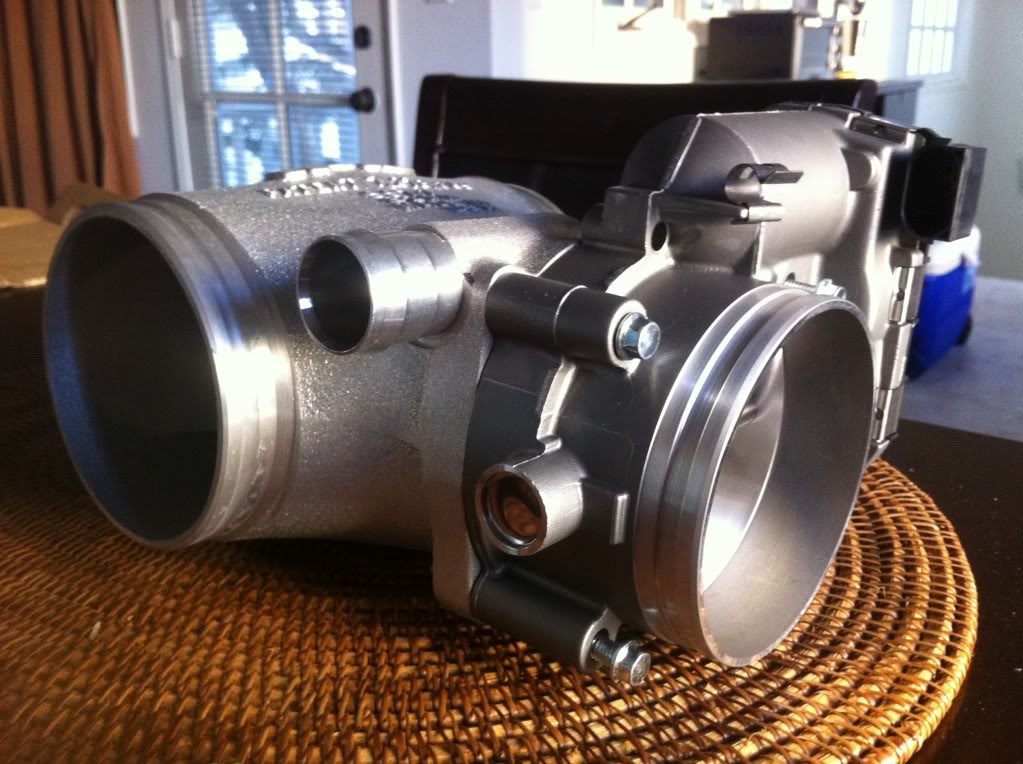

Originally Posted by JoelPirela
... My decision was based on trying to avoid machining out the IDP competition to 84mm from 82mm; and being a true plug and play procedure...
I installed the new IPD 997 Comp plenum with an GT3/X51 throttle body. It fit together perfectly. No machining necessary.
And, according to IPD, the rough finish performs better than the smooth finish.
That said, if Nello had his plenum available six months ago when I got the headers, cats, mufflers from him, I would have bought it.

Are the X51 and GT3 throttle bodies the same? 84mm?
I believe so.
Here is a pic of my IPD and TB mated up
Yes, the X51 and GT3 throttle bodies are the same. The part # is 997 605 116 01. It is almost always referred to as the "82mm throttle body", but MaxSpeed says that it is actually 84mm. It's probably a matter of how one positions their digital caliper. Whatever they measure, it is the exact same part.

Finished up the install... Pretty easy if you know how to unscrew and use a screwdriver! LOL!
Everything went smooth. The only challenging issue was the rubber boots since they are stiff, but checking Cattman DIY on the plenum installation gave me some tips.
The difference between the original TB and the X51 TB is like a B cup and a DD cup!!!!!
Everything aligned and matched with no trouble. Take your time making sure the clamps are placed correctly and tight, so you won't have an air leak.
The OEM plenum is a ****ing joke. A piece of plastic that looks like garbage.
I did the battery disconnect before installing the new TB and then, after the install, reconnect the battery and place the key on the "ON" position and waited 30 seconds. This is not mandatory but it will avoid the rough idle you will get for few seconds while the ECU adapts...
Idle is rock solid and steady and the car revs faster. There is noticeable sound now that I didn't hear with my regular plenum, 74mm TB... is a more deeper sound and like a woooooooshhht when accelerating from idle. I really like it.
Driving hard, past 4000 RPMs is where the car now wants to be... it gets there faster and start screaming. I can tell a different behavior.
Does it makes 27 HP? Nello from Maxspeed Motorsports is a smart guy and doesn't advertised any HP gain claims. He is bringing a solution to those who want to install a bigger TB on their cars. Again, mine is a 997.1 Carrera... "Non S" and I couldn't be happier.
Install took all of 45 minutes.
