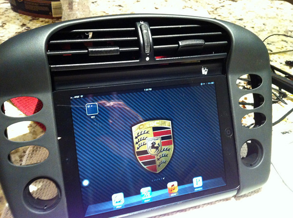

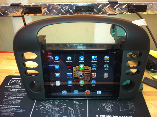

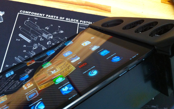

Joe, your project turned out great!
I had some time this past weekend to make a bit of progress on my own iPad mini install (996 MkII).
A few prototype pictures...
In this particular install, the only OE part I've had had to cut/modify is the horseshoe bezel. I always like the option of returning everything to 100% stock, and the bezel is only about $60. It looks like it just dropped in, but it actually took a fair amount of trimming on the bezel to get it to fit properly. It is now sandwiched quite tightly between the bezel and the radio/AC support plate, no play or movement. It's not designed to be removable (updates over wifi or through USB cable), but pulling the horseshoe bezel is pretty easy if I do need to remove the entire iPad for service.
By the way, your suggestion of ordering a cheap Chinese iPhone dock and cannibalizing it for a 90 degree cable connector was a great idea! I ordered one and pulled out the little ribbon cable with connectors on it from the part. It turns out that I don't need it though. With this current mount, plenty of room for a hidden conventional lightning cable.

awesome! that looks perfect!
btw, it's pretty funny that I have the same glock mat that I use to work on my desk!
keep up the good work and let us see more pictures once you install!
