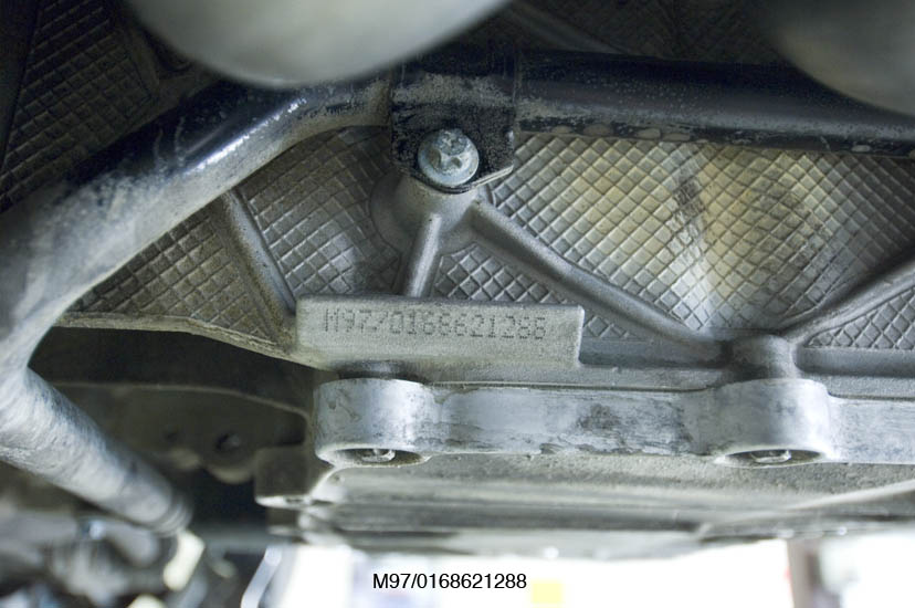

Hella...I was under the impression all '05 model had the weaker IMS and it wasn't until early model year '06 that the upgraded bearings show up. Is that not the case?
Is there a good way to check? Some type of code on the door or whatever? A site where you can input VIN or engine code?

It was changed mid 2005. If you run your VIN you should be able to get the engine serial number. You could also ask the dealer. My car was built in late 2005 and I have the revised larger bearing and wold be curious.
yes, if you know your engine number then there is a way to know if you have the smaller or larger revised IMS bearing. You can find the number etched on the left side of the engine. See pic (I got this pic from a rennlist member (dan)).

Holden,
So, after having found the number, how does one find out if a newer bearing is present? Is there a code within the number? Does one go to another site, plug in the engine number, and the site/software would show the part #?
I am just curious.
Thanks.
