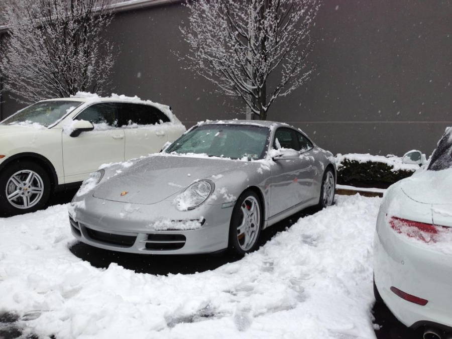

Final Update:
I got my car back after it being in the shop for over three weeks or so. The majority of the wait time was due to the dealer working with the aftermarket warranty company. It only took about 5 days for the engine to be delivered and installed after approval from the warranty company.
My new engine is SN: M97/01AT68666682. Judging my Holden's number reference on page five of this thread, the new engine appears to have the larger IMS. I have the print out of the paper work that came with the new engine, but all the numbers are associated with German words (therefore I don't know what specific numbers mean). I can only read "serialnummer".
Finally, for those curious about costs, the replacement engine cost $19,205.58 and the total was $21,341.80. It was pretty cool to pick up my car from the dealer and they just handed me the keys with an invoice that showed $0.00. I am very glad to have my car back! It feels as though nothing ever happened

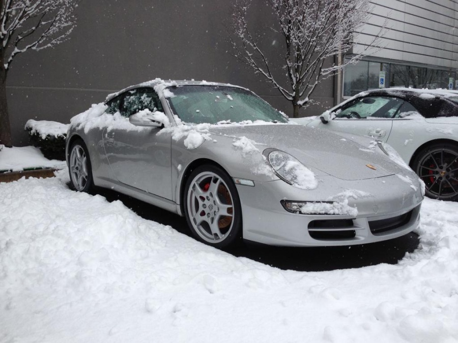

Here she is when I picked her up a week and half ago. I was surprised how well the C2S with summer tires dealt with the snow.
Love the pics of your car in the snow. Glad to hear that this ended well for you...enjoy!
