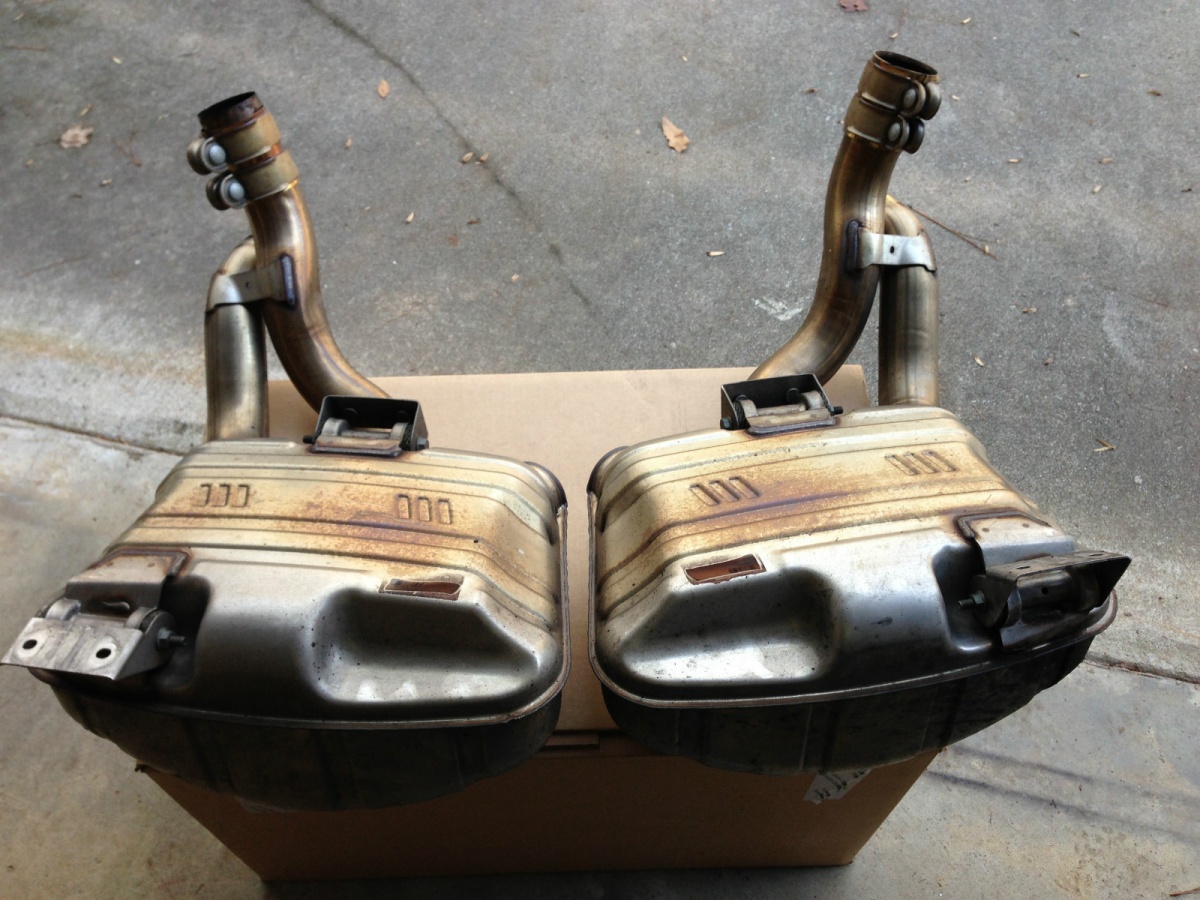

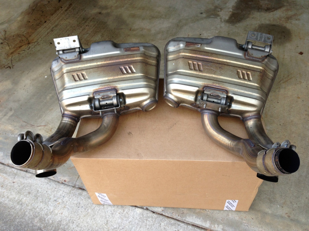

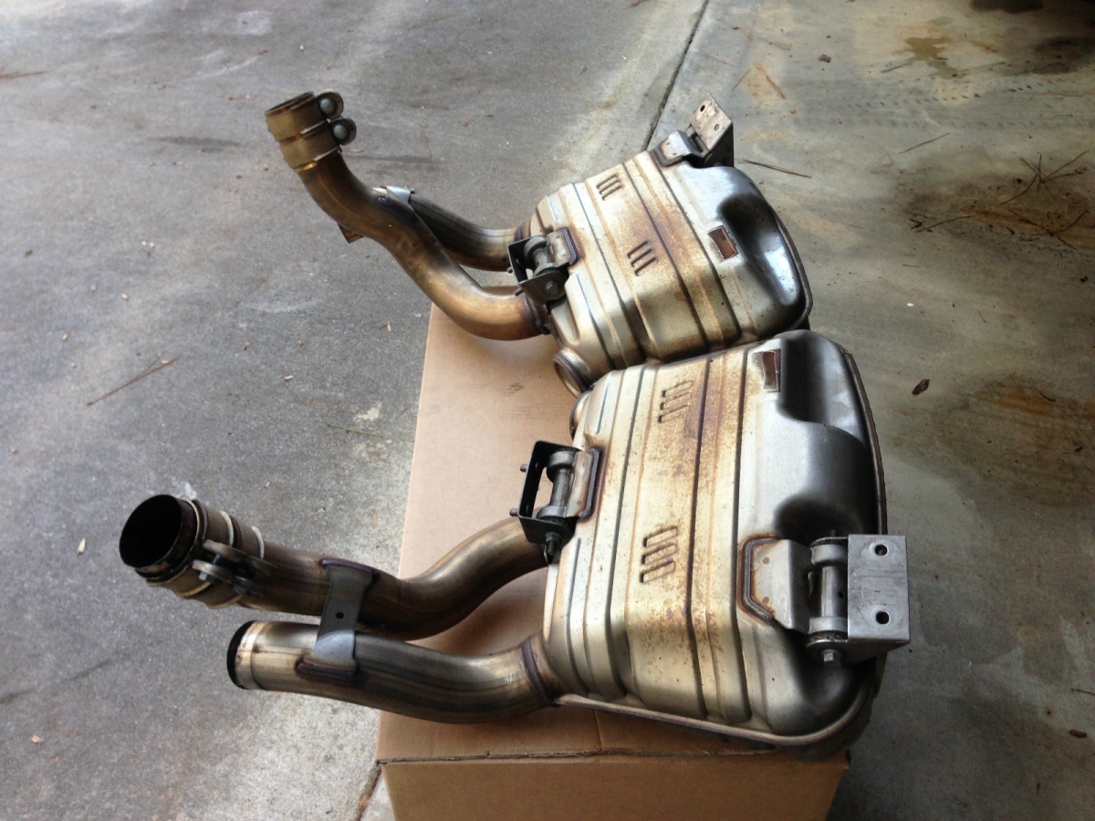

Originally Posted by AlohaSC
I live in a neighborhood with rather restrictive noise covenants. I want to do the Gundo hack on my 997.2 CS, but I may need to go back to stock if my neighbors get too bent out of shape. Consequently, I want to do the hack on a second set of mufflers and keep my original mufflers stock just in case I need to reverse the hack (go back to my stock mufflers.)
Eventually, I may be forced to invest in a stock PSE system so I can turn the PSE on and off. However, I would like to try the Gundo hack first as it is much more cost effective.
If any of you guys are upgrading your 997.2 CS exhaust with an aftermarket exhaust and you want to offset your out-of-pocket cost, I am interested in purchasing your stock mufflers.
Thanks,
Warren
Have a set of 997.2 mufflers off my 2011 Carrera Cab. They have about 3500 miles on them. Selling them on eBay <http://cgi.ebay.com/ws/eBayISAPI.dll?ViewItem&item=150979115883>

Yes - a 3.8 has the same mufflers whether it is a wide-body or a narrow-body. And 3.6 mufflers will not do.
