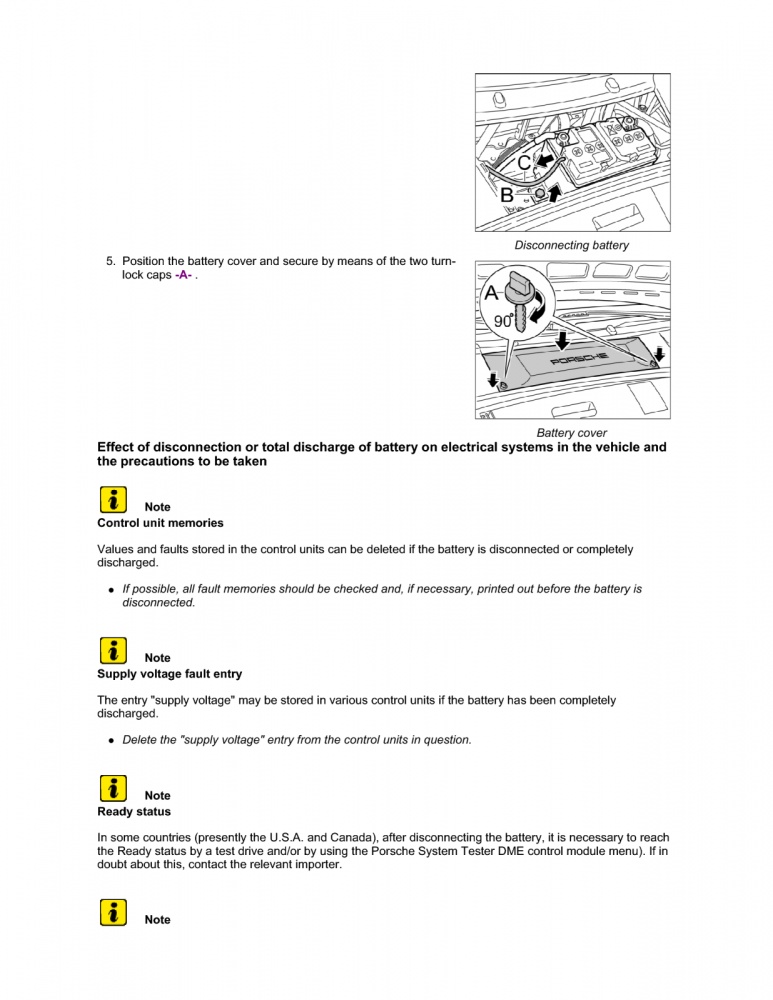

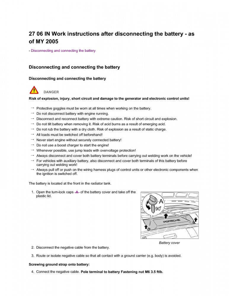

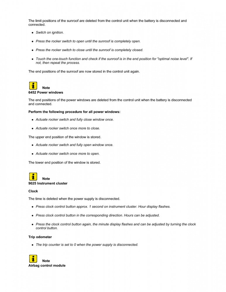

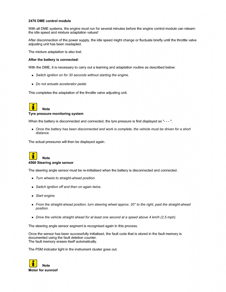

Disconnect negative terminal first and reattach last. No codes to worry about all that needs be done after the reinstall is window memory. Run em up and down a couple times and the memory will return. It's in the owners manual. Any codes you get on the dash will disappear after you drive off in a minute or less. As for battery types , battery must be vented and reverse terminal type. Who ever you buy the battery from will be able to advise.
