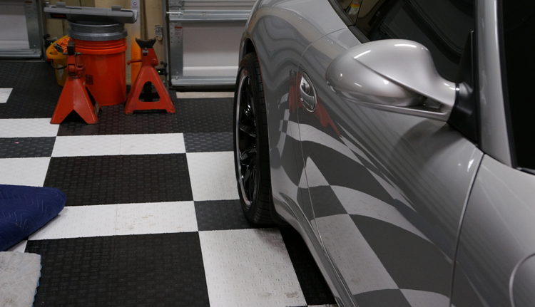

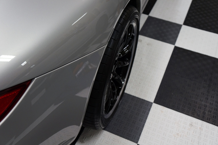

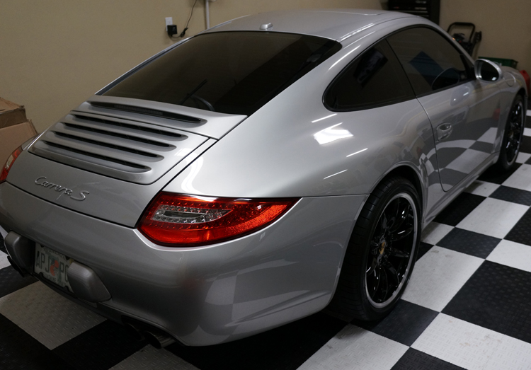

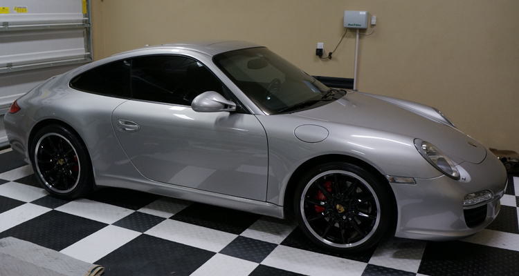

Installed these tonight on my C2S, they're off of a GTS. There's a definite difference from the 67mm offset wheels I took off, is this sticking out too far?

I say yes.

In the rear, yes. Might even cause a bit of road rash on the rear fenders. Kind of a "boy racer" look in the pics, but may not be as extreme in person. If you like them, then you're the best judge.

In my opinion, it looks off... I've had only the factory NB wheels on since day one. If the suspension travels enough, I could definitely see the tire hitting the fender.

From the pics, front may be o.k., but the rear tires... I bet they rub.
I like the black wheels with the tint, good luck on the fit.

Agree...something is off. Wheel width more than 11" in rear. Do you still have spacers on perhaps.

Too far out. Color combo is great. Not liking rear look. Voting no.

something looks off. i have widebody turbo wheels which sould be the same width and offset and they dont stick out that far.

I agree with most. The front is OK, but the rear sticks out too far.

I have the factory 997.1 turbo wheels on. Rears are 19x11 ET 51. And I run 295s.
Your wheels in this picture set are .25 inches wider (.5 inches divided by 2 plus one mm for the 50 offset) and the 305 tire is more square than a 295 tire. I think that is adding to the visual protrusion.

I prefer wheels that don't stick out. You are going to mess up your paint and to me it looks funny. I would not run those for fear of damaging the paint.

seems to be unanimous, they will be in the market place shortly... Thanks for the opinions.

GTS is a wide body-that's why you are sticking out too far!! Can you say "Road Rash"
