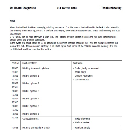

I was able to pull DTC codes with my VagCom (VCDS) cable for my Audi.
Looks like misfires across all cylinders:
Thursday,21,March,2013,22:00:56:24777
VCDS Version: Release 11.11.5 (x64)
Data version: 20121222
Mode 07: Pending emission related fault codes
Address 11 (Engine): 15 Faults Found:
P0300 - Random/Multiple Cylinder Misfire Detected
P0301 - Cylinder 1: Misfire Detected
P0303 - Cylinder 3: Misfire Detected
P0305 - Cylinder 5: Misfire Detected
P0306 - Cylinder 6: Misfire Detected
P0302 - Cylinder 2: Misfire Detected
P0304 - Cylinder 4: Misfire Detected
OBD DTCs erased
I cleared the codes but have not ran the car yet. I will test tomorrow & see if they return.
Any idea what would cause misfire codes across all cylinders?
Thanks.

I drove the car about 60 miles today & the issues seems to be resolved. So it was either a loose oil cap or dirty MAF, but not sure which.
Thanks to those that posted advice.

i just posted over on RL (and here too? i cant remember) a couple wks ago about the same issue - misfies galore. but i also had codes that pointed to the MAF so i cleaned it off which seemed to solve the issue temporarily...until i got to the track. in my first sesssion, i started going into limp mode after only a few laps. turns out it was a loose ground connection on the MAF. i jury rigged it to stay in place and no further troubles the entire wknd. i swear, i hate that little son of a b*tch MAF. are you KIDDING me with all the havoc it can cause???
bottom line is i think the original issue was a dirty MAF causing the misfires. but i think when i unplugged it and cleaned it was when the wires in the connector became dislodged causing the limp mode. i hate that thing.
