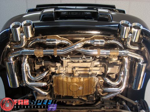

PSE uses the existing CATs.
This photo clearly shows the headers, mufflers and CATs. The only thing you replace is the mufflers themselves. Of course you can also change the headers and CATs as well if you see fit. I did X51 headers when I installed my PSE.
Old Apr 18, 2013 | 09:16 PM
911Stud's Avatar
Joined: Jan 2013
Posts: 193
From: Jacksonville, FL
911Stud is infamous around these parts
Interesting...on the stock configuration, the cats sit a little closer to the runners of the headers, and where the cross over pipes are, there is a giant canister instead. Which is why I was wondering if the PSE kit comes with just the 2 mufflers (side mufflers) or if it also brings a replacement for the center canister, which would be right where the cross overs are.
Thanks for the all the help and illustration.
