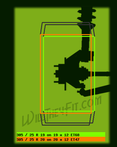

Hi guys, I am interested in purchasing a set of wheels -aggressive offset and I want to see if it will fit my NB 911S.
the wheels I currently have are OEM gt3 wheels w spacers.
Front: 8.5 x 19" - 53 mm offset with an additional 14mm spacer.
Rear: 12 x 19" - 63 mm offset with an additional 7mm spacer.
these are the wheels I want...
20x9 ET 56 5x130
20x12 ET 47 5x130
will it fit?

I guess if someone could tell me how much more the new wheels would stick out I can judge for myself. the set up I have has it flush all teh way around.

20x9 ET 56 5x130
20x12 ET 47 5x130 = WB offsett
68 mm offset = 2.677 inches
47 mm offset = 1.850 inches
the smaller the offset the more the wheel will be pushed to the outside of the car...
