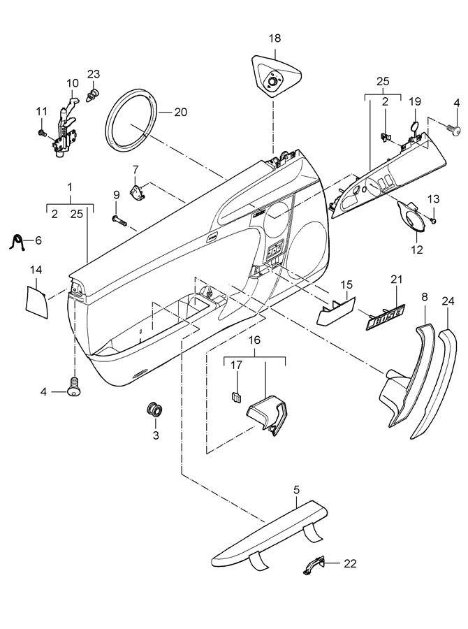

Yes you can replace it yourself, but the door panel needs to come off. Once the panel is off you can see the broken piece.
It's likely #10 in the diagram, "axle bearing" part no 997.555.381.02. Dig around for a door panel removal DIY here or on rennlist. I also recommend getting a few #3 "fixing clip for mount door trim panel" as these break easily during the door panel removal. Total parts cost should be less than $20.
