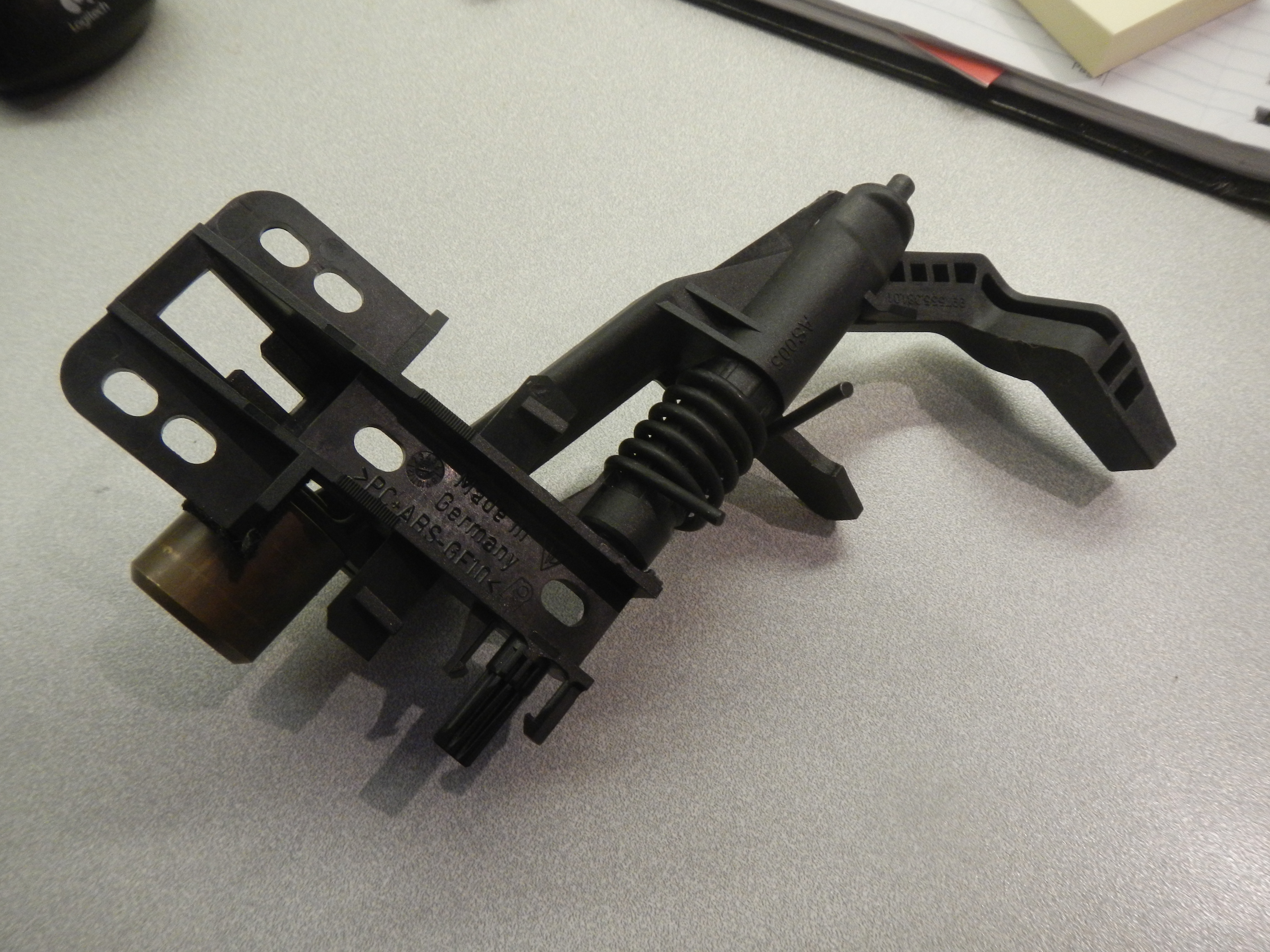

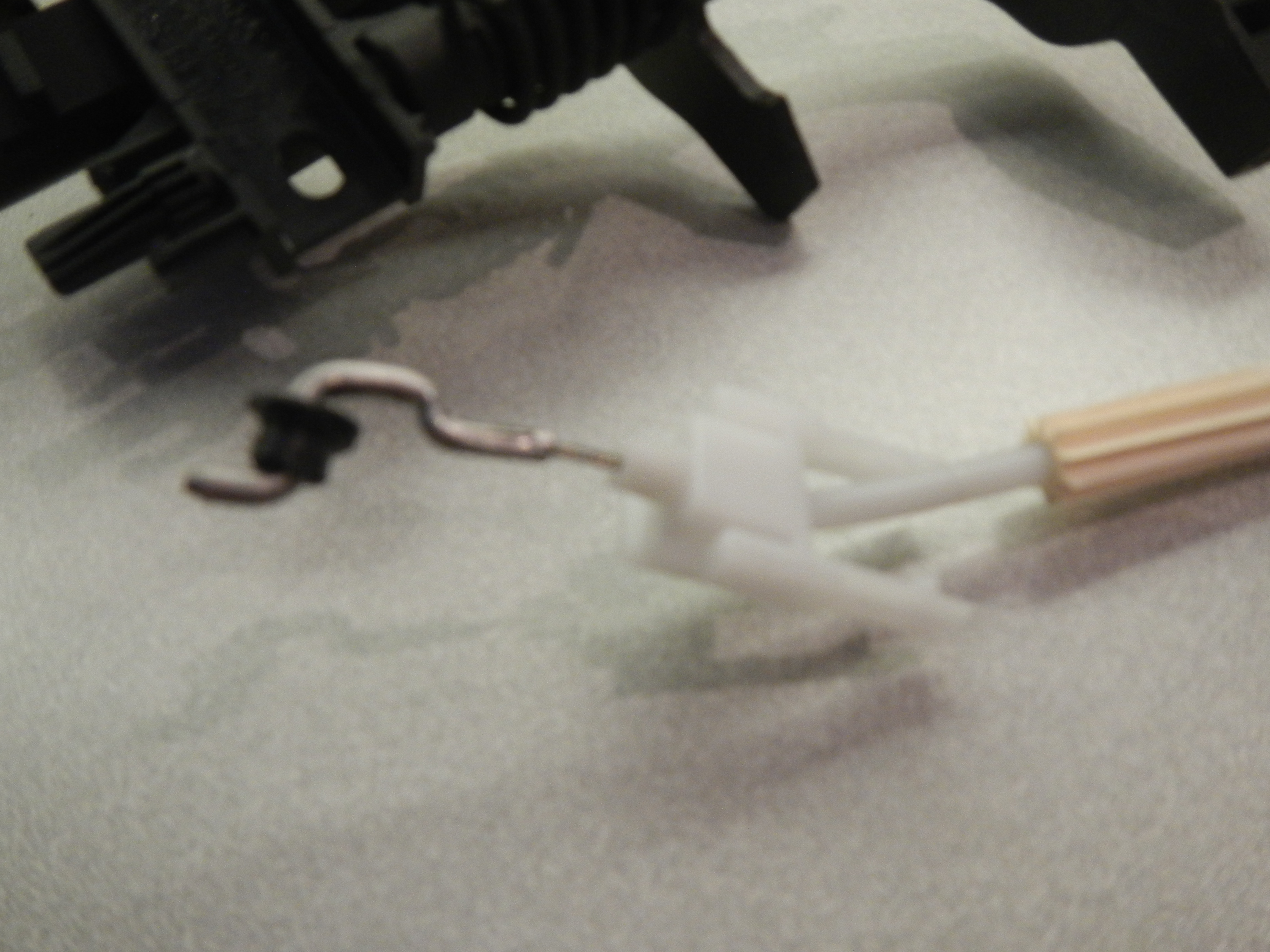

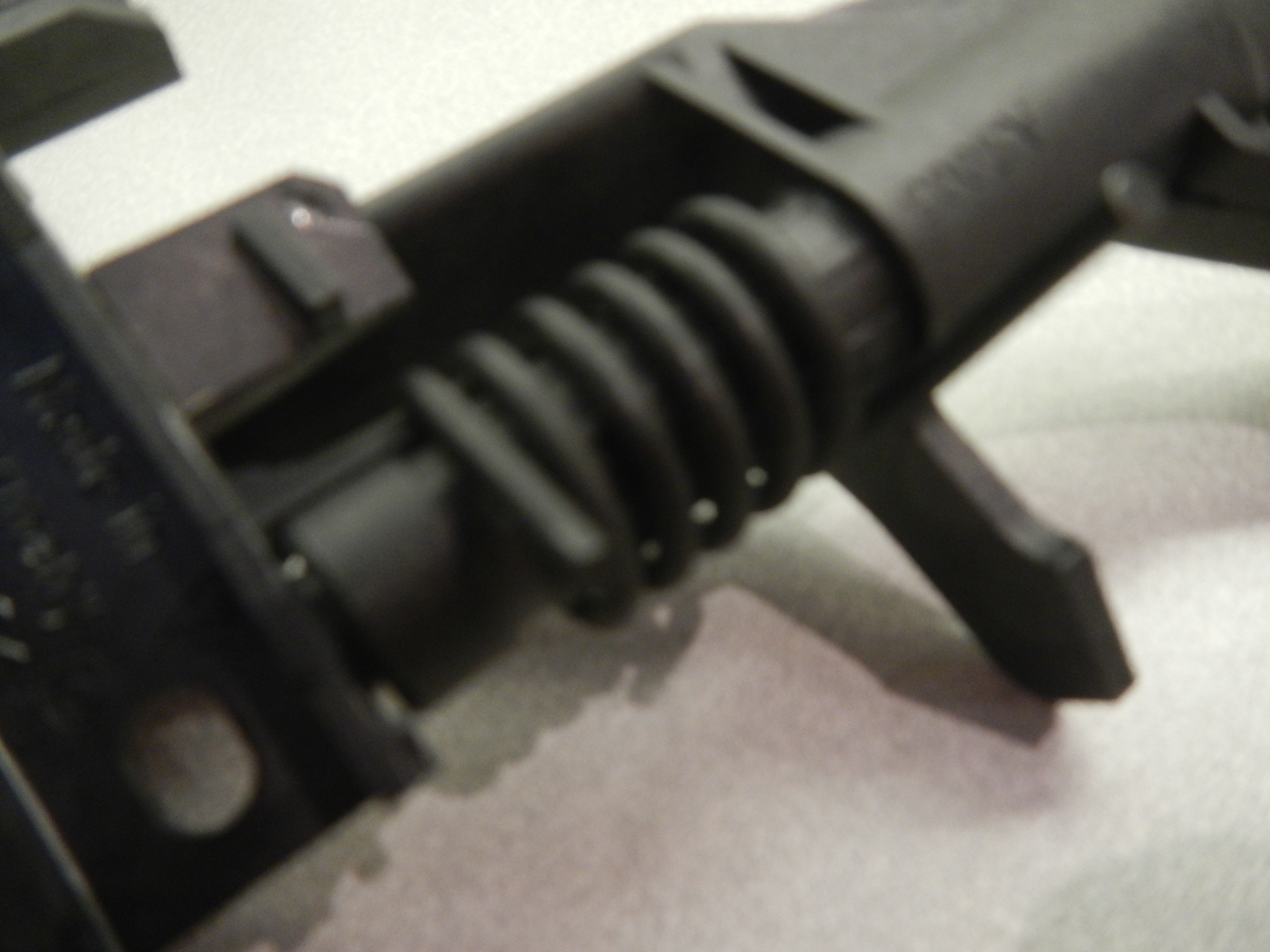

Thanks to the great information on here, I was able to easily repair my broken door handle. The only challenge is the new handle design requires that you also change the cable. This involves removing the interior metal plate and undoing the door latch so you can pull it partially out and insert the new cable. You will need a 12 point driver (30 or 40 mm) to get the latch out.
As noted follow the link to Renlist on how to remove the door panel, its very easy. The new cable has a different barrel type end instead of the old bent end with a plastic bushing . The parts (new latch, cable and 8 new door grommets (they break when you pull the door off) was only $45 at the dealer. This fixes the floppy door handle that started after that popping sound. The noise is the spring letting go when the plastic stay breaks off.

Can you show us a pic of the part that actually broke? Mine just broke a few weeks ago and it would really help to be able to see it. Thanks!

The first pic shows the door handle. Note the spring on right side. You can't see well, but look at the bottom of that side, there are two small tabs that stick out on either side of the small rode. There should also be two point upward at the bottom of the spring, note the small tab on the right is missing. That allows the spring to come loose and the pop sound you heard was the spring uncoiling. Just note that the cable and handle need to be changed because the design has changed for the handle and cable end. Good luck.
