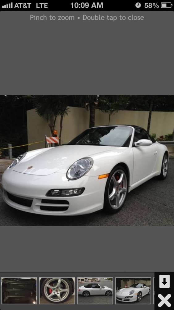

This is the 2008 S Cab picture. Both are gorgeous. I will try to upload more pictures. Thanks Gloves

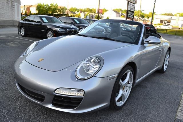

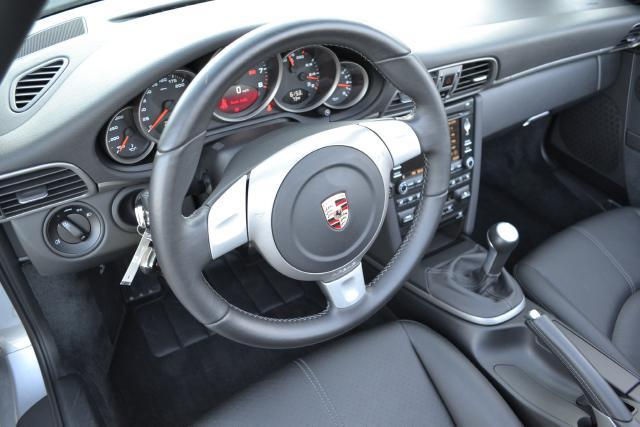

This is the 1009 manual shift. Beautiful one owner car and I started to like this car more than the 2008 but it is not S model. Also, I can't inspect the car in person :/
