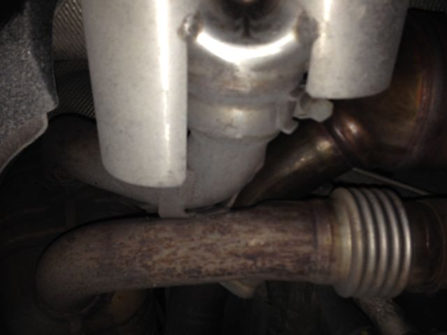

Thanks, Romy.
This is the pic of the outlet pipe joining the tips. So it doesn't look like it has the PSE, right?

It sure doesn't!

Got it. Thanks!

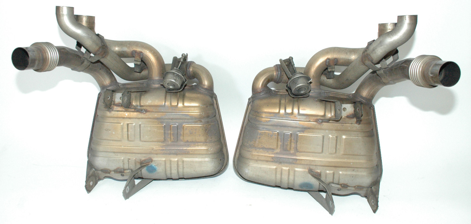

Here's how it looks like.

I might consider this (of the Tubi exhaust) as my first mod ;-)
