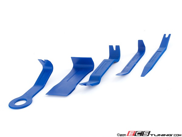

A lot of people use the 5 piece trim molding kit like the one below. For more information Click Here.
Jonhunt - We actually had a PDF with instructions if you haven't found any yet. For more information Click Here. Hope this helps.
