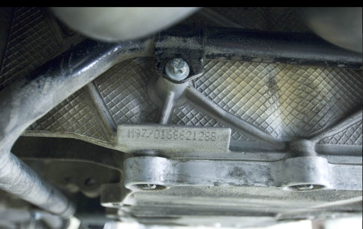

excellent info. quick stupid question - where is the easiest # stamp to find? do i have to crawl under? (which i do regularly but tonight when i check, i am hoping it's easier/found topside or elsewhere!)
Old Aug 7, 2013 | 01:13 PM
kerlow66's Avatar
Joined: Sep 2012
Posts: 37
kerlow66 has a spectacular aura aboutkerlow66 has a spectacular aura aboutkerlow66 has a spectacular aura about
You don't have to crawl under its pretty visible on the driver side just bring a tooth brush and water to scrub it down some so all the numbers will show when you take a picture with yor phone.

AWESOME info... checking mine today thanks to this glorius info. Sank youz!

Exactly where is this? Under neath on the drivers side or access from the engine lid?

Driver's side. Underneath. Pretty easy to spot once the grime is off.

See post #11
