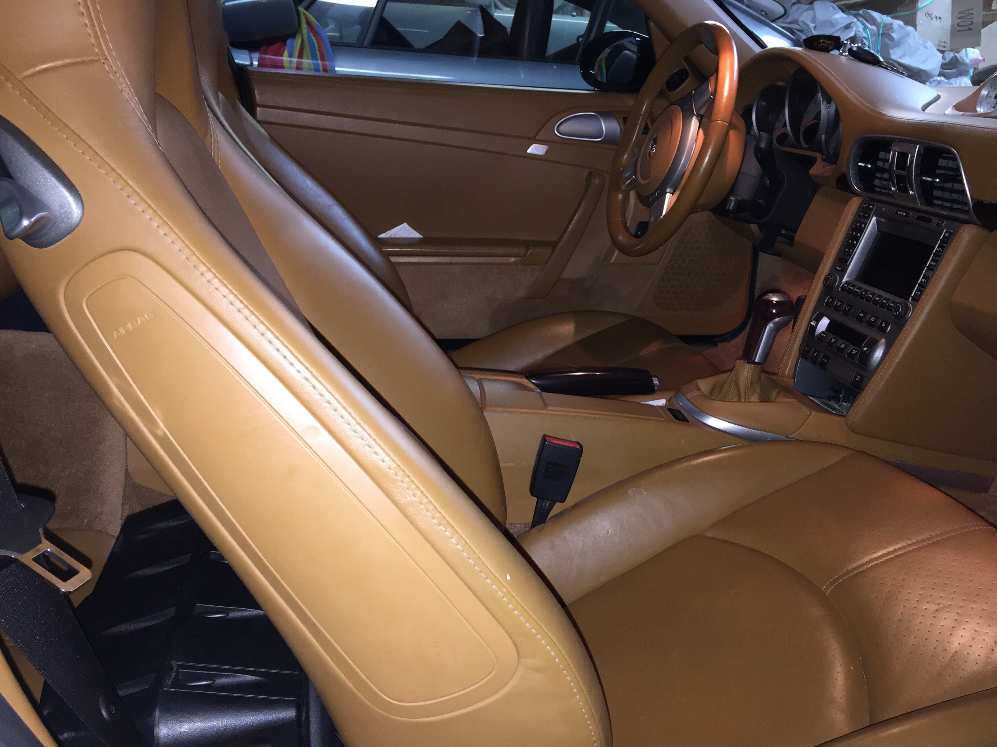

Here are some pics. I am supplying a few more so you could see the orientation of driver and passenger seats relative to each other.
I haven't studied how to connect the BasLink so not much help there.
Btw, how wide and long is your future Bazooka?

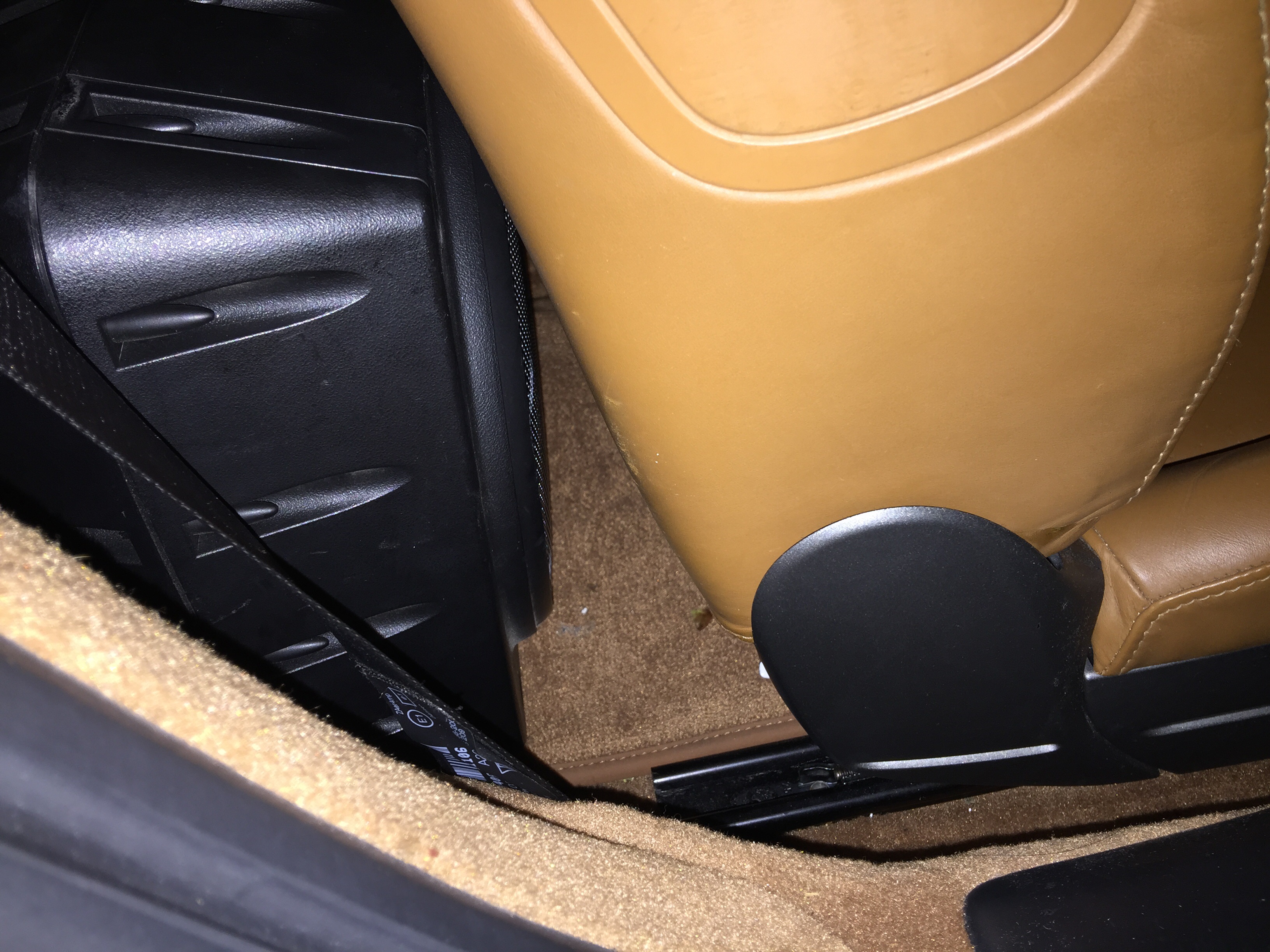

I like my seats at an angle. If your seats aren't as angled as mine, you would have more "front leg room"
