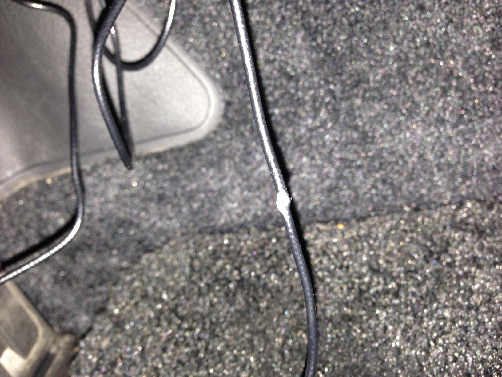

So I looked over the antenna wire and found a place where it was sliced down to the metal. I'm guessesing it happened when I was messing with the subwoofer. Is there a way to repair it or just needs to be a new one?
See the pics below.

I'm not aware of any way to repair that small cable. You may need to find a new antenna with cable attached, since they are usually hardwired at the antenna end. You can often find them on eBay quite cheap, assuming yours is a standard one like the ones used on "Roady" XM radios etc. Good luck.

That's the mini-coax cable. It's just like the cable for TV, only smaller diameter. Inside is a solid core single wire. Around that some insulation, usually white plastic. Then braided ground "mesh" all around the plastic. Finally the black plastic outer wrapper.
I can't tell by the photo if only the ground braid is showing or if its deeper. If it's just ground a quick repair should work. I'd start with black electrical tape, make sure the overall wire is straight in that area, and reinstall.
If all else fails, then replacing the wire would be next. Sometimes its connected to the antenna, which means a complete antenna replacement. Usually around $20 or less for parts.
