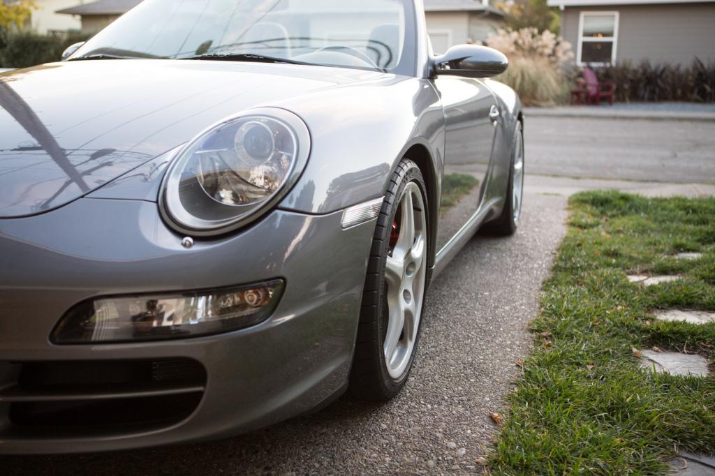

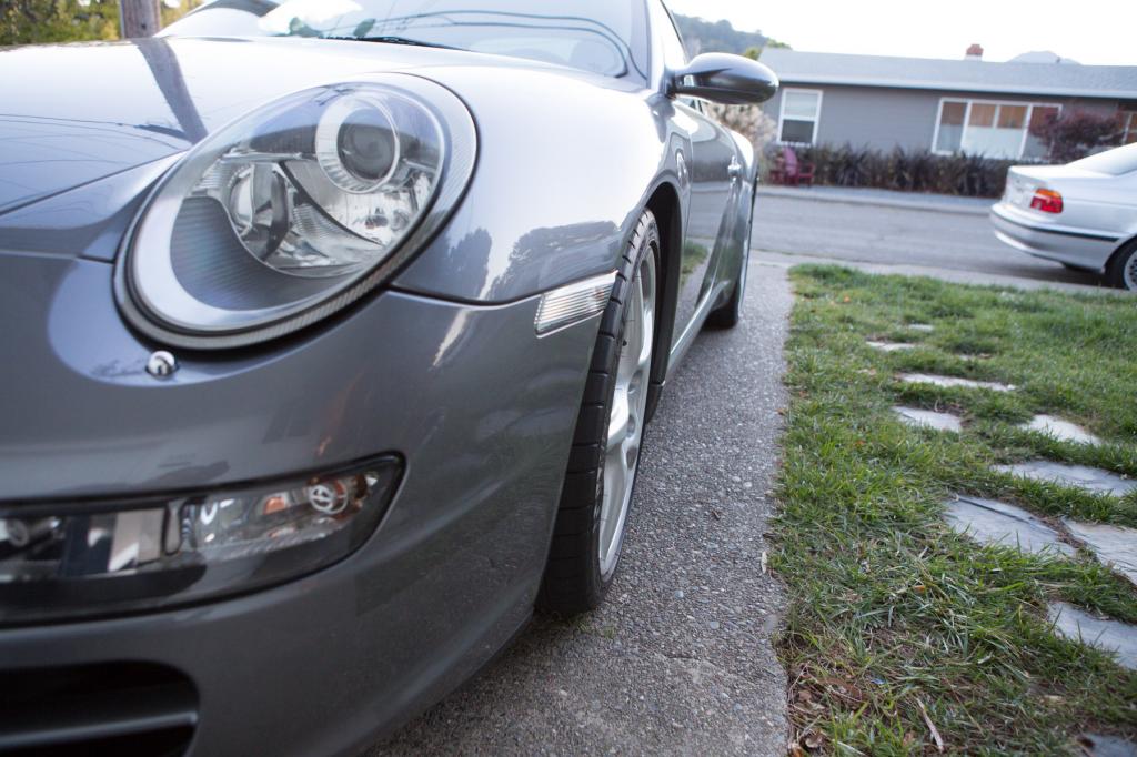

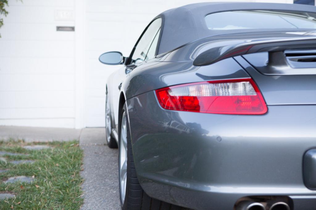

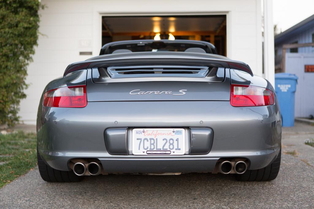

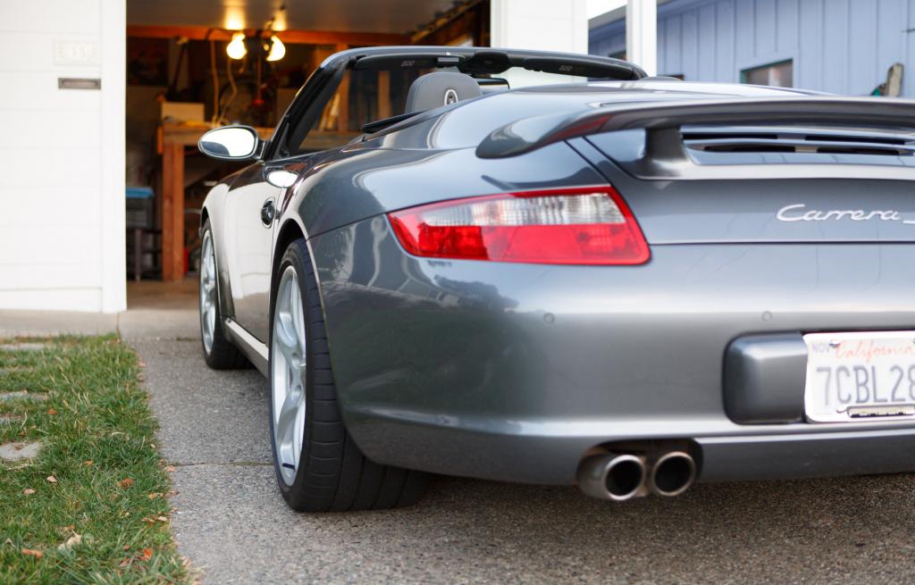

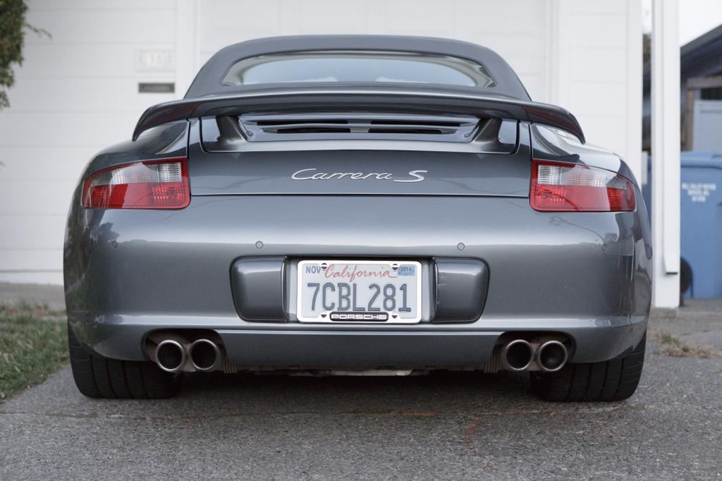

I got my RSS 7/15mm spacers installed today. It's true. They're the perfect combo for my car.
I didn't take the best "before & after" pics, but here are some that I did take.
BEFORE:
AFTER :
BEFORE:
AFTER:
BEFORE:
AFTER:
I may try and take some better photos over the weekend if anyone is interested, but I'm definitely glad I got the spacers they really do put the wheels where they belong.
Hopefully these photos are helpful to any other users who may have been on the fence or unsure about if they would be too much.
