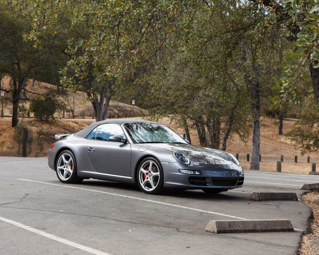

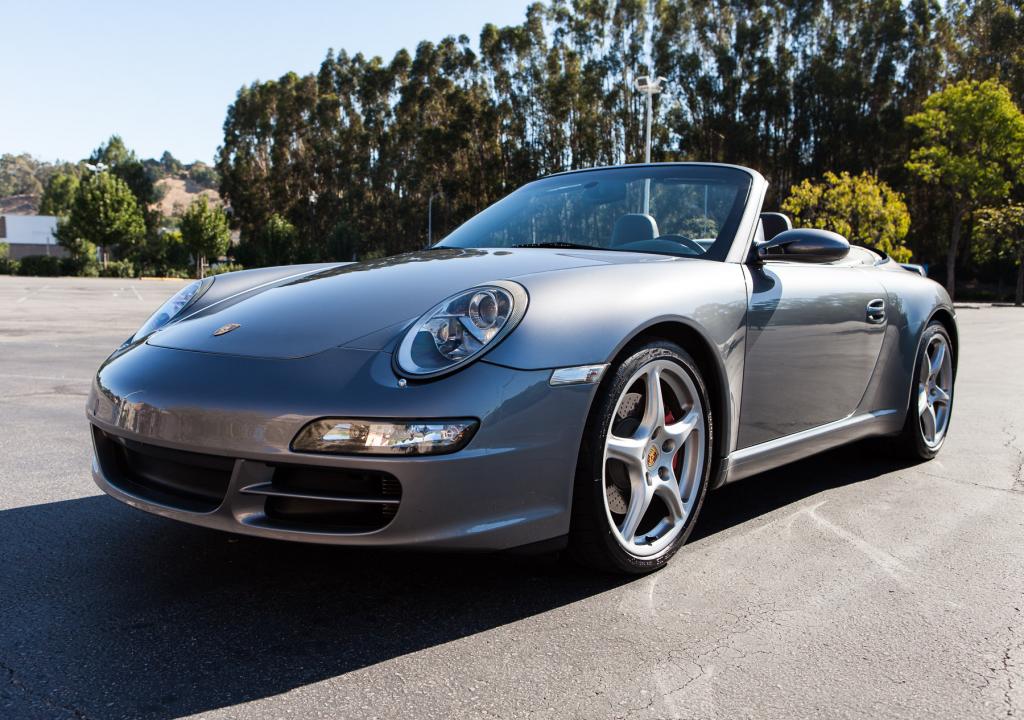

I would love to see moar pix if folks have some. I'm interested in spacing mine out too.
I've got the 997.1 C2S Cab, with the 19" Carrera Classic Wheels. I would really love to see photos of this set up with spacers like mentioned here.
Here are some pix of mine with the stock set up, using stock spec tires for reference (295's out back):

Wow! Thank you all for this advice. Looks like I'm going to try the 7/14 or 7/15 combo. I'll take some before/after shots.

Beauty!
Very nice! Thank you for the great pics!
