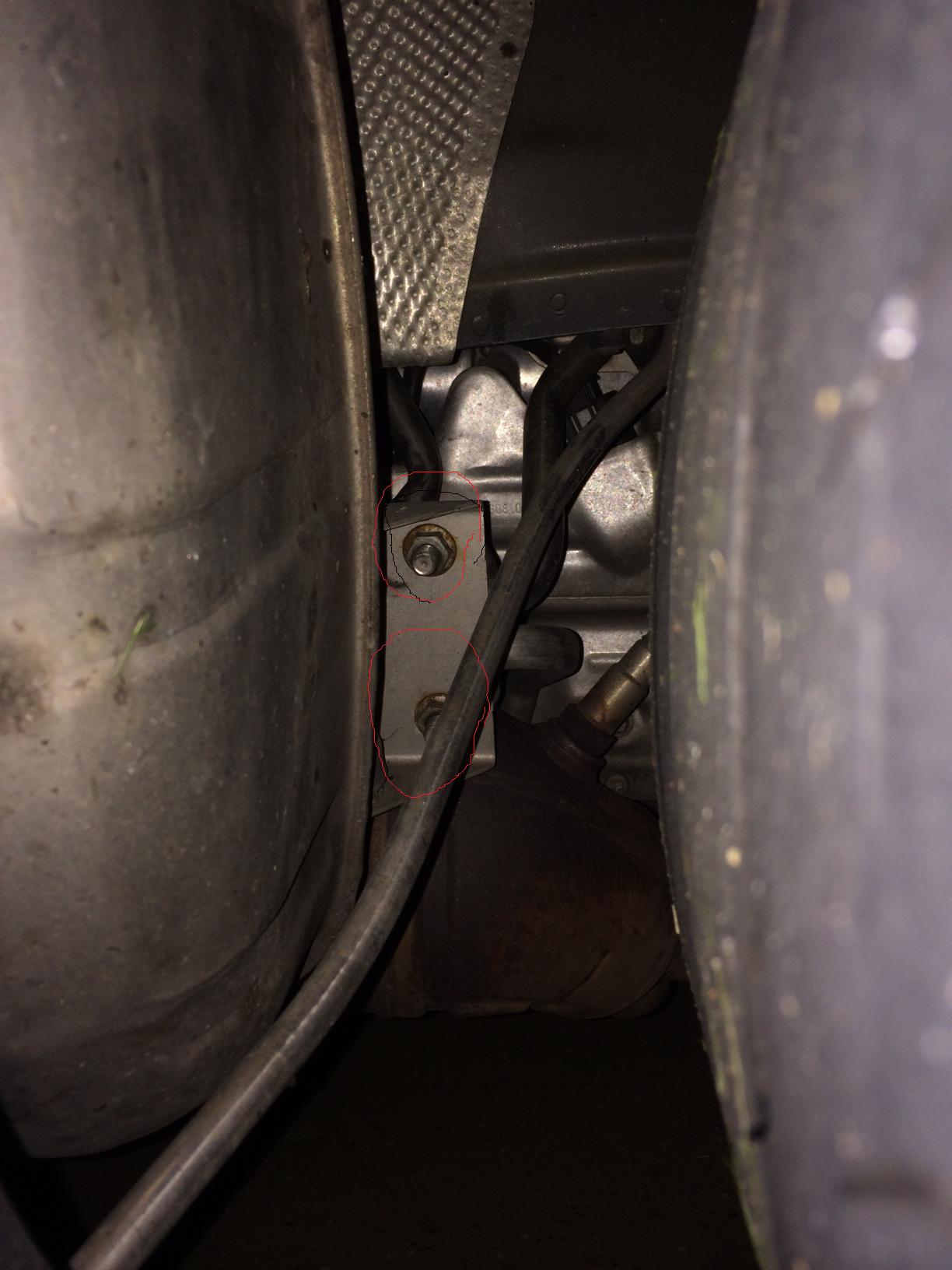

My 997.2 had plugs changed about 4-5 months ago
The mid muffler has not been removed.
The rear muffler was removed along with the bumper and thus the access was easy.
I think in your pictures you showed the mid mufflers, which did not have to be removed.
See photos.
In Plug 6: taken from back of car, looking under exhaust, this is a picture of the pipes leading into the "initial-mid muffler" Not changed/not touched
Plug 5: Looking from below the car just behind the right rear wheel. The final muffler (one that leads to exhaust pipe) lead into this one, and as you see, one bolt and nut have been changed to remove the "last/final muffler"
Top pipe leads into mid muffler, and bottom pipe leads out from mid mufler to final muffler which is "in the bumper cover)
Plug 4: The back of the "Final muffler" is attached to a bracket. That is removed along with the "final muffler", it lets you access the plug cover, tin metal behind the 2 screws
Plug 3: the two hex screws are removed and it removes the tin cover which lets you access the plugs. All circled in red
Hope this helps. Based on what I see from your pics and what I compared with my car. I think you need to get more information.

you are correct that the mid muffler can stay in place but in the pic he showed the clamps on the mid muffler have to be loosened to get the side mufflers off. They did nt appear to be touched. That place where you have a new bolt is questionable on the OPer s car. If I understand what you are saying....
You are right. I missed that one.
Third picture in post number 2. (the one with three pictures)
The 2 bolts side by side, one of them, the one towards the back of the car should have been changed if they really did it.
Look at my picture "plug 5"

I loosened both of those bolts to remove mine. They are just clamps. Anyway I think we all agree (including the dealer) ....

Update: the dealer admitted that Porsche protocol calls for the removal of the mufflers and that the tech that did the job the first time did not do it this way. It's my guess that Porsche requires the removal of the mufflers because this is the only way to properly get the torque wrench in there to torque the plugs. The dealer willingly removed everything to verify that the plugs and coils were indeed changed. Upon doing this, they snapped pics of 6 plugs that looked fairly new....well, they didn't appear to be 4 years old. At least not in my opinion. Whether or not the plug threads were damaged because a torque wrench wasn't initially used, who knows. I guess time will tell. At least, I have it documented at the dealer as well as with PCNA via a customer feedback survey.
I don't know where to really go from here.
Bottom line: trust, but verify....always.
