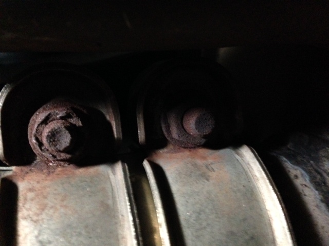

I took my '09 4S in about 4-5 weeks ago for a plug and ignition coil change. I attempted this myself, but sheered one of the bolts off (one that connects the muffler to the catalytic converter). To be honest, I have a lot of rust on the bolts under my car and this was the main reason I decided to take into the shop for this procedure.
Fast forward to yesterday, I decided to check out the work that was done. I mainly wanted to see if the dealer replaced the bolt that I sheered off. To my surprise, the sheered bolt was still in place, completely rusted out (as a point of reference it's the middle bolt in the pic below...thanks DGrayling, Rennlister, that posted this). I called another dealer and they said the only way to get to the plugs and ignition coils is by removing this...at least this is what the Porsche shop protocol calls for. There is also no signs of any of the other muffler bolts being removed. They are all pretty rusty and should have at least shown some signs of a tool being on them.
I will post pics of my undercarriage for your feedback. Was the work done or not? I appreciate the community's input.

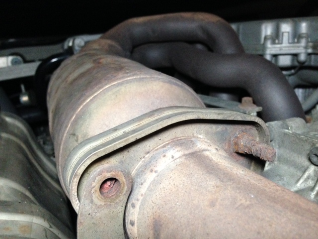

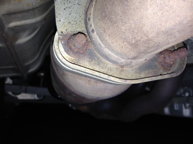

Notice the sheered bolt that is still rusted and in place.

well I just did mine without removing that section of exhaust....
even after removing mine some of the bolt esp on the center muffler are very rusted and look like I didn t touch them when in fact I did.
Dunno...

well after seeing the second set of pics I would wonder too.

Do you have a 997.1 or 997.2? I used to do the plugs on my 997.1 without removing this section too.
How do you get past the muffler pipes on the 997.2 without removing the muffler? Also, I was just informed by 2 P car shops (including the one that did the work) that mufflers are removed for a plug change.

997.2 I did remove mufflers only, not the beginning section of the exhaust where you snapped the bolt. Center muffler stays in place and the only thing needed is to loosen those clamp bolt.

Pretty sure you can change the plugs without removing that piece. Next time ask for the old spark plugs.

To replace my spark plugs and ignition coils last month on my 2007 c4s. I did not have to remove the mufflers. There is a shield in front that had to remove as well as the wheels. I did remove the mufflers about2months ago and 3 of the bolts sheared off , what a pain. The rear clamps also sheared off but were easy to replace with stainless. The bolts on the muffler flange had to be nocked out with an impact gun so i could replace them with a new stainless nut and bolt. The bolts on the flange for the muffler are pressed in place. (977.) I would say the muffler would have to come off to fix that sheared bolt.
Hope that give you some insight about the sheared bolt!!

Porsche protocol calls for the mufflers being removed. The problem with leaving them in place is that you need to use a universal joint on the wrench and once you introduce this you cannot torque the plugs to the appropriate value (22 ft lbs). The tech and I discussed this and this is why Porsche calls for removal of the mufflers.
It raised enough suspicion with the dealer that they are taking the car apart to verify. I was also informed that the tech that did the work is no longer with that dealer.

Those bolts seemed untouched! Good luck and keep us posted.
