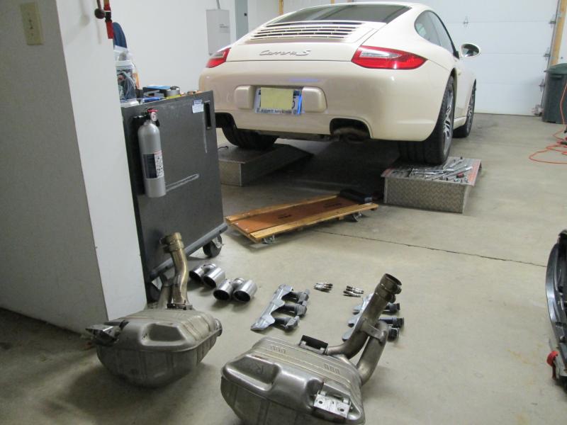

As I have past the 4 year mark on my car and have only 14K I decided to change out the plugs as recommended by Porsche.
There are DIY post on the net already. and being 1/2 way through the job I d say its a 7 out of 10 difficulty.
Took a good 6 hours to get everything apart and then I was only able to hand tighten the spark plugs while I await a torque wrench I ordered to be sent.

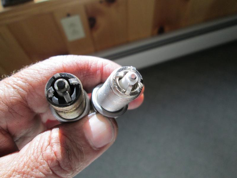

Here are the old and new plugs.
all old ones looked the same.
They felt a little rough coming out.

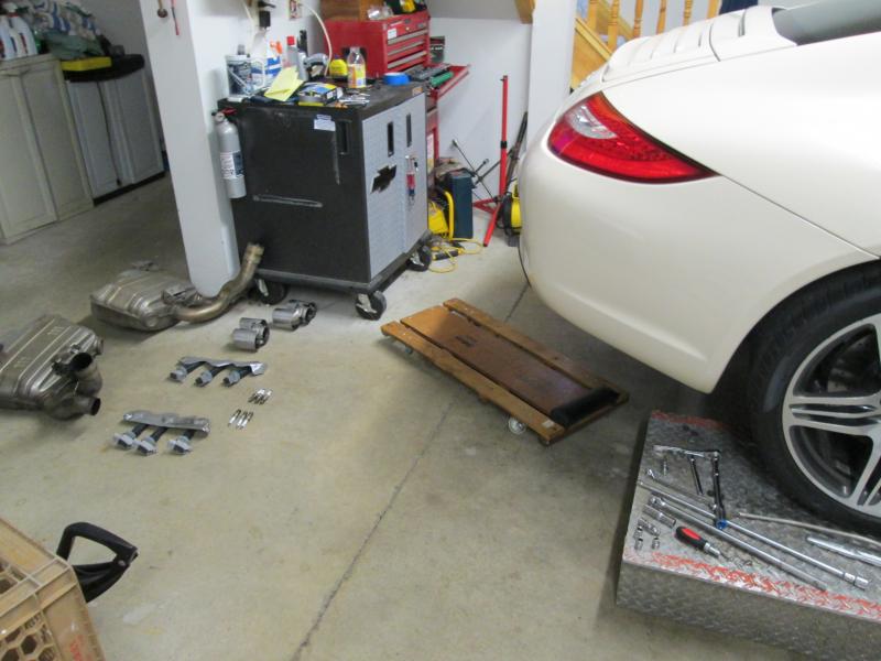

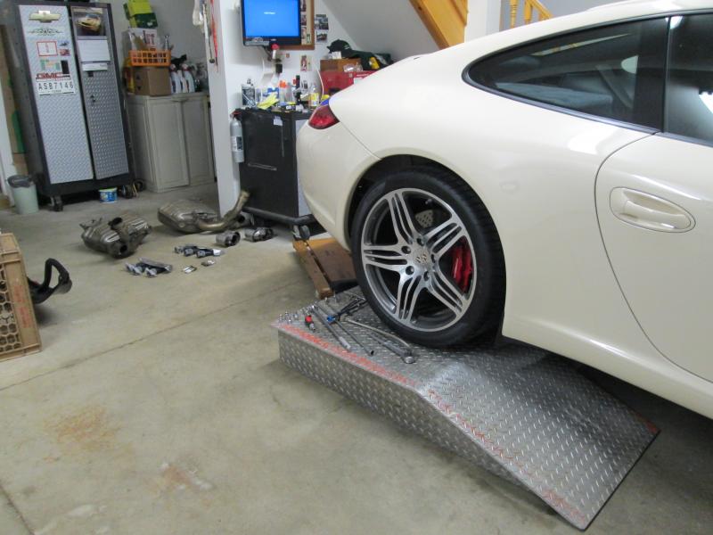

Note, I did not remove the wheels.

Old ones still look ok nothing a good cleaning could not get out. What will we expect from an engine that has just run 14k.

Great work. I like your diamond plate ramps. Do we need to remove the manifolds?

No, just the parts you see on the ground. I think you may be looking at the heat shields and coil packs on the ground.?. Don t know how its possible with mufflers left on by it s reported the dealer works around them. Those ramps are what trucks use for loading docks .

I guess how it s rated also depends on experience. I was most worried about breaking an exhaust bolt or rounding one out. That is the most time consuming part of this job. Also the spark plug heat shields are a b### to get off. I didn t want to take off any exhaust sensors which may have made it easier. So you have to just work them off like a puzzle. Working on your back doesn t make it any easier.
Wheels are not in the way. Plus if possible I rather leave the car raised on those ramps (no jacks).
I have had that section of exhaust off already so I knew it would be time consuming. I wonder how much easier it would be doing this on a lift and what secret tips Porsche techs have to make it go faster.

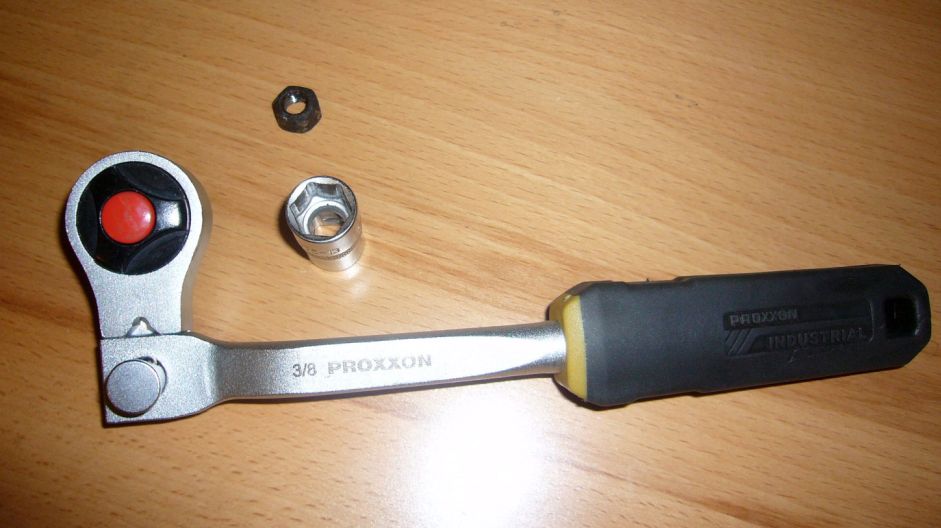

I replaced all the rusted exhaust nuts already in preparation for the spark plug change. This wrench came in real handy. I also soaked the nuts multiple times before attempting to remove them.
