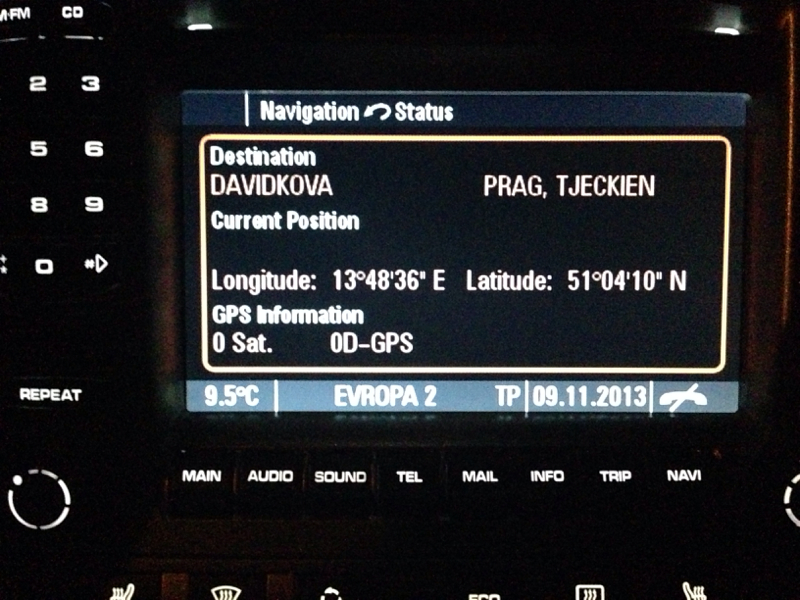

Hi, I just bought used 2006 997 with PCM Navi. I tried Navigation. Navigation start navigate, but is absolutely inaccurate and unuseable. I checked status and there is not GPS Signal (0 Satelites). Have anyone experienced same problem, broken PCM or antenna? Thanks for help

Radku
is this a Euro version car, or is this a US car relocated to europe?
In that case they may need to "Reteach it the satellites"
We use different satellites for Nav here than in Europe.
I know that on my portable nav That I took to Europe for the summer I had to "Reteach it the satellites to use"

This is European car. I will take car to service tomorow and they will check antenna conection.

If it is Euro, then most probably the antenna as you said

Antenna and all wires are ok maybe faulty pcm.
