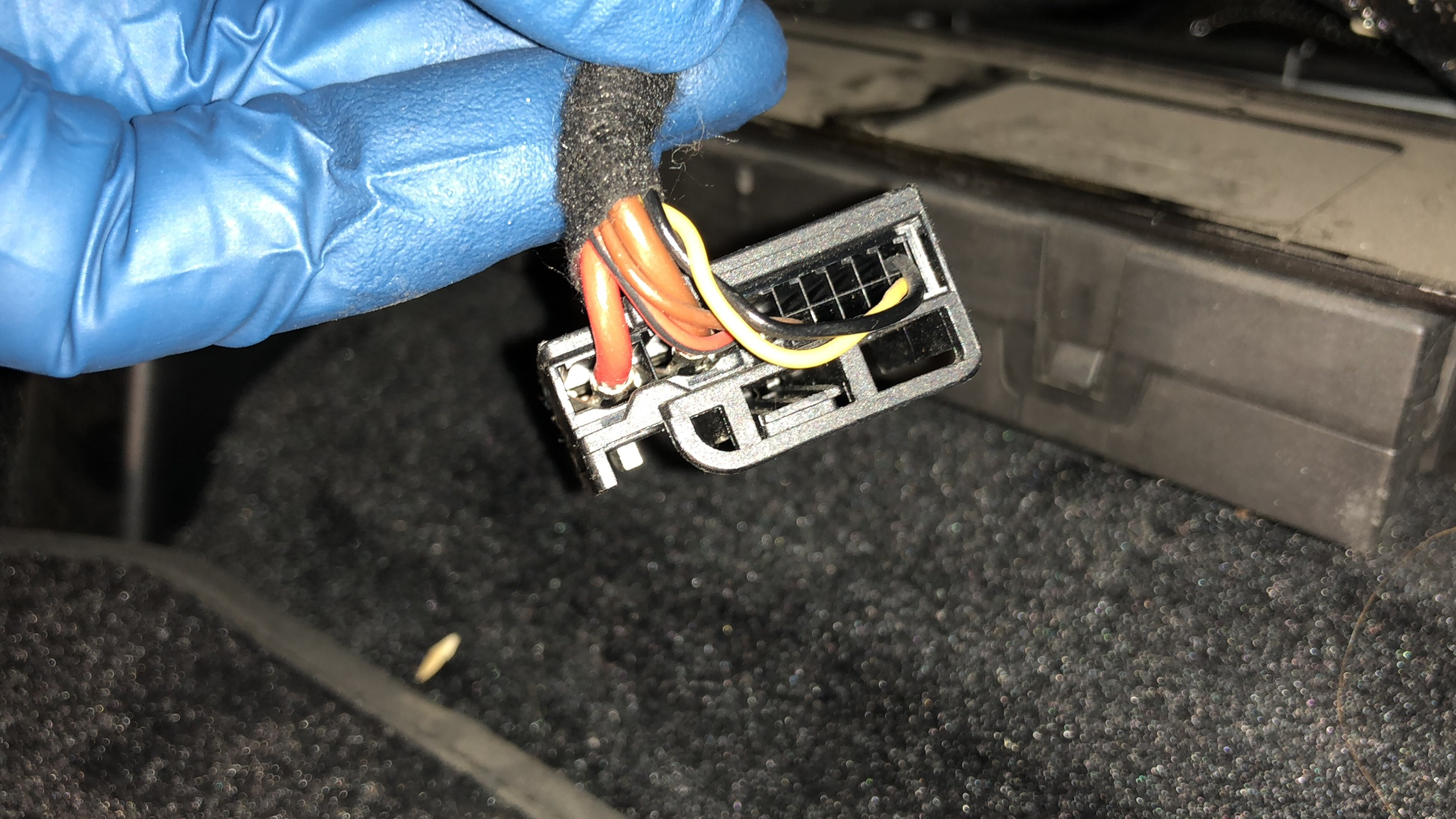

I’m also looking to swap my seats and trying to find out what is involved installing a non-memory sports seat into a memory car with regular seats. Does anyone have tips to share on what’s involved?
The block box under the drive seat is the memory module and when it’s disconnected all power to the seat is lost.

Hi newold, been a while since I thought about this. I'm no longer in my 997. But, if memory serves me you are on the right track with regards to the seats. I was trying to go from GT2 seat equipped car to donor seats with memory function. I was never able to to make that work. Passenger side would work, but the driver's seat wouldn't work without having wiring harnesses plugged into both plugs of that black box.
Now, sounds like you're trying to go the other way A memory enabled car with non memory seats. Sounds like you already have the donor seats already. Probably safe to assume the passenger seat works fine? When I was going through that fiasco I came to the conclusion that the driver's seat power for a memory enabled car cam from the larger wiring harness that plugged into that black box.
So, in your situation, I would think that you could jump the power from your memory seat wiring harness to the proper pin of the other harness. You'd probably want to hunt down a picture of the harness from a non-memory car and compare it to the harness of your car that fits in the seat. see if you figure out where the power goes.
My intuition says that it should be a lot easier to go the direction you're going If you can run power to that seat it should work.
Now, I have no idea how the airbag is wired in a memory car. I'd be a little nervous that any wiring to the airbag would go through the memory module. But, I suppose the car would throw an error if the airbag wasn't powered.
I wish you better luck than I had doing your seat swap!

Thank you for the detailed response megachip!
Yes, I’m trying to install non-memory seats into a memory equipped car. Physically don’t have the seats but looking at the wiring and browsing though various forums I’m pretty confident that this swap is do-able. Fingers crossed...
The memory module has the main power input (red/brown) and I don’t see any others ‘thick’ cables going into the regular yellow connector so I think what’s needed is to get the 12V power from the memory module into the yellow harness to power on the new seats. I can definitely see installing memory seats in a non-memory car can be an issue as the memory module expects the power.
