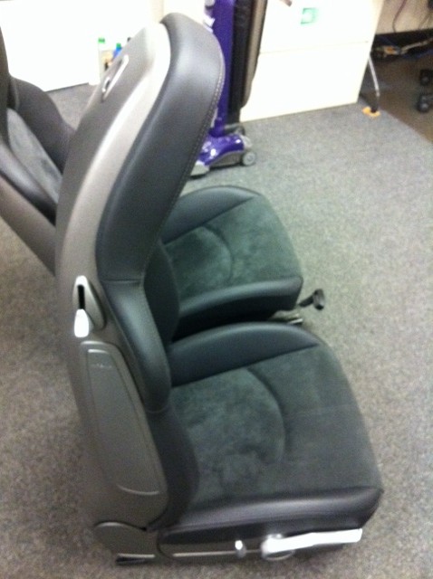

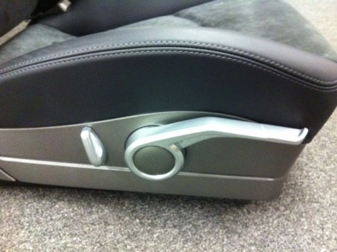

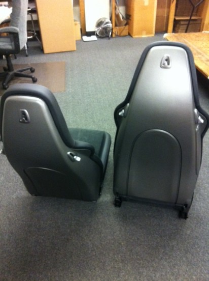

2007 GT3RS Factory Sports Seats: with alcantara inserts.
They are power recline and manual slide XLT condition; no scratches.
The leather and alcantara are like new. They are plug and play &
have integrated side airbag. The seats have all of about 100 miles
on them, before they were removed from the car and it was converted
to TRACK with Race Seats.
Research shows GT3 Seats will fit ALL 996, 997, 986 (Boxter, Cayman).
$3500 /set of 2 .
