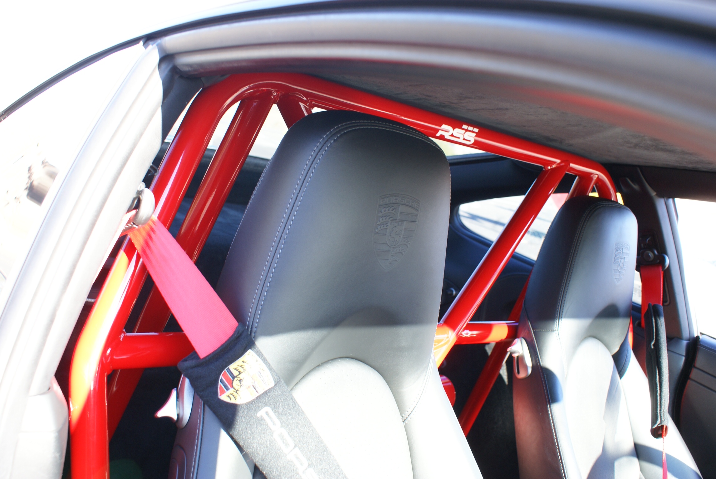

Just wanted to say thanks to Mike and Bryan at RSS for the great customer service they gave me with the purchase of my RSS Roll Bar. Installed myself, took about 4-5 hours. (didn't want to break anything)

Awesome! I'm installing the exact same bar in Guards Red in my car next week, just haven't had the time yet. I've hear fitment is 100%... Glad to see how great it looks. How much does it restrict the seat movement?

RONX1,
I am 5 11" and I have my seat adjusted to the same spot. I would think you may loose 2-3 inches depending on the angle of the back part of your seat. I also replaced the seat belts to guards red from Nello at
Maxspeed-motorsports.com I did the seat belt exchange.
When you go to place the bar in the car I strongly recommend having another set of hands, and using a tie down ratcheting strap to pull the sides together. Makes life so much easier.
Good luck with your install, and remember be Patient!!

Me like. Is it direct bolt on? Need to cut carpet?

Slick 911,
This RSS Roll Bar model 901 is a direct bolt on. It bolts to the front seat belt and rear seat belt threads. It's not attached to the rear struts, so no need to cut the carpet.

Thanks! That's a plus being a direct bolt on. Very tempting.

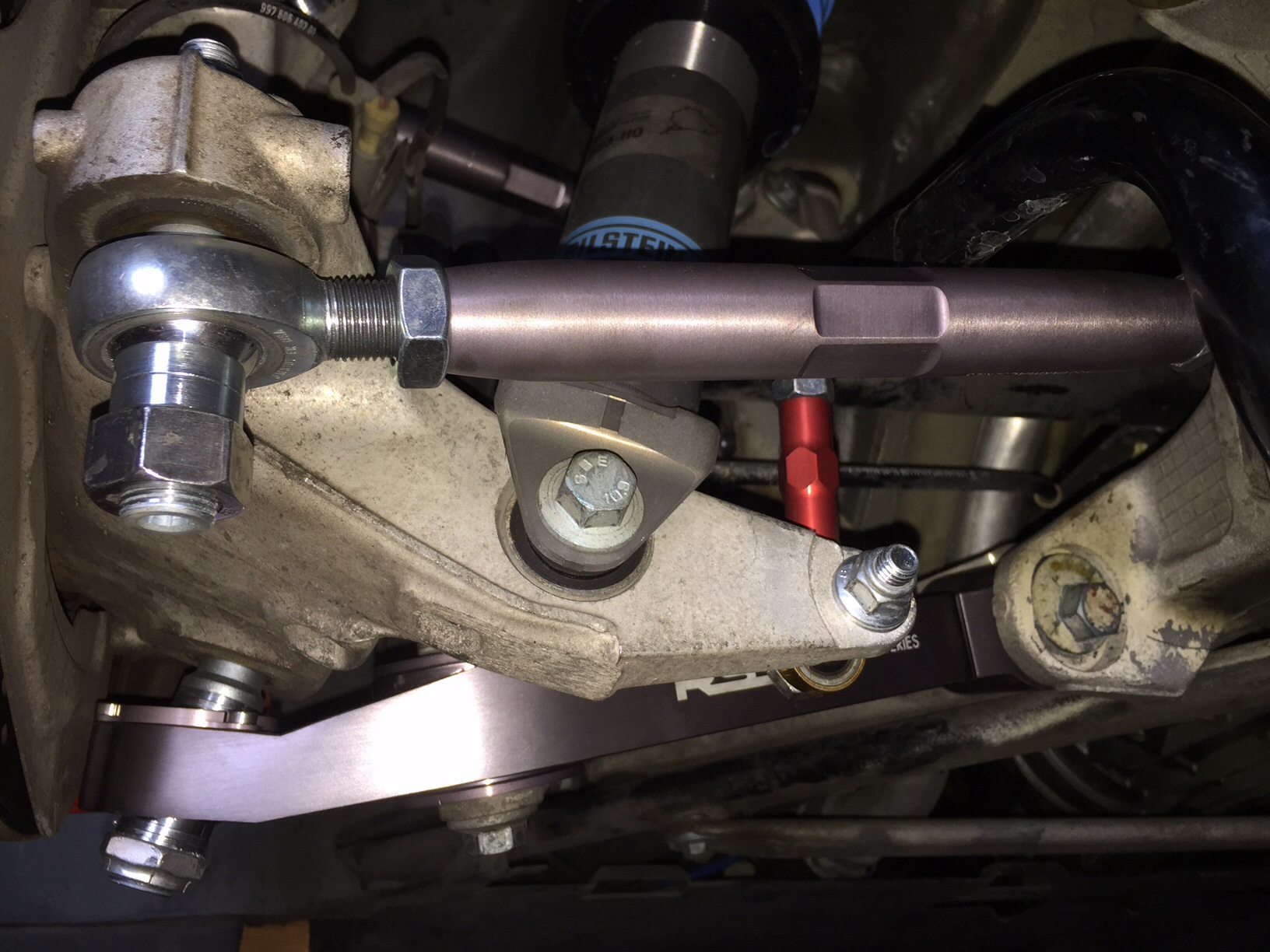

Smile Another Thanks to Mike from RSS
Just wanted to throw out another thanks to Mike from RSS for the great customer service with helping me purchase my Tarmac series 2 suspension package. Installed all the parts yesterday, now need to get it aligned!!

Looks great
