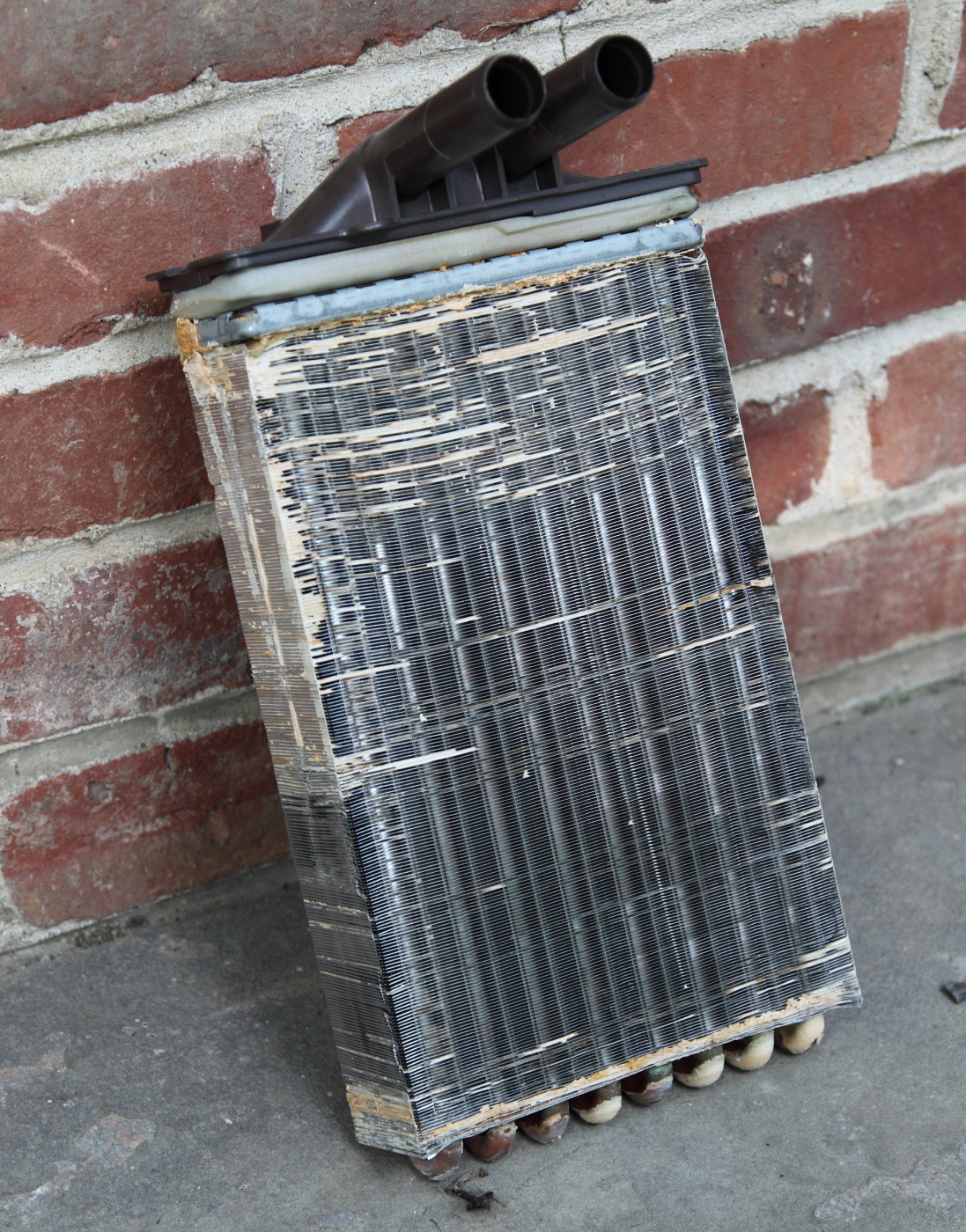

Bruce in Philly is a glorious beacon of lightBruce in Philly is a glorious beacon of lightBruce in Philly is a glorious beacon of lightBruce in Philly is a glorious beacon of lightBruce in Philly is a glorious beacon of lightBruce in Philly is a glorious beacon of light
I had the same for about 6 months and never saw a fluid drop in level. The problem was the heat exchanger had a tiny leak and that is where you cabin air passes through. I tried deoderizer.... various folks looked at it with all kinds of possibilities. The only way I got a positive ID is that I pulled it out. Very easy to do, just unbolt a bunch of stuff. It sits between the battery and the "fire wall". You must pull the wiper cowling, the wiper motor and mechanism, the frame braces, then pop off the hoses (minor dripping), then unscrew the exchanger and pull it up. Very easy actually.
EDIT: I just re-read your post and you noted the smell was from the rear of the car. If you don't smell it in the cabin, then my recommendation is probably not valid.
I replaced it with an OEM equivalent from Pelican (it was the same darn unit and I saved money).
Boxster 2000 S (same set up in our 911s as I understand it)
Peace
Bruce in Philly

Old Jan 7, 2014 | 06:31 PM
MJRizzo's Avatar
Joined: Nov 2012
Posts: 141
From: new jersey
MJRizzo is infamous around these parts
I ordered a cap to start . I see a little white powder stuff on plastic container under cap on overflow tank. I never smell it inside , only when I get out and pass rear of car...I might have smelt it once when front hood was open but maybe it was in the air . The car was inspected by Porsche when I bought it two months ago and nothing came up . Let's see if its bad cap and I'll hope for best ..Thanks
