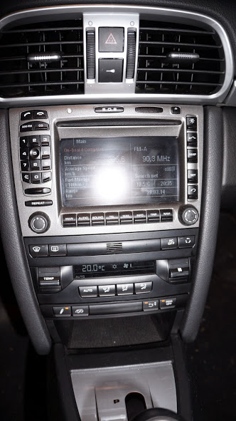

I had a spare hour to try the "Doner" idea.
I have no idea how to do this - the buttons on the 997.2 unit are not in the same positions so I don't know how to make 1 set work with another circuit board...
Plus the frame for the button holder is different - the one does not fit properly into the other :-(
So either need Expert advice form somebody who has done this or I would need to try the re-wiring.
Or just paint the damned old version :-)

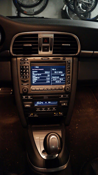

Originally Posted by JoelPirela
you use the holder and the front fascia of the 997.2 and only use the circuit board of the 997.1. the back connector need to be tweaked/dremeled down a bit to take the 997.1 plug from the car. it took me all 15 minutes
Well - it took me 4 hours...
Joel, i checked your pictures - you have a panel with 2 or 3 buttons right?
if you only have the furthest apart buttons the circuit board works. if you have 4 or more buttons this will not work, the inner buttons are too far out of alignment.
SO, i plugged in the 997.2 board.
the lights, and half the buttons worked, i then spent a couple hours finding the right pins for the other 2 buttons. well happy now though :-)

Daytime images
