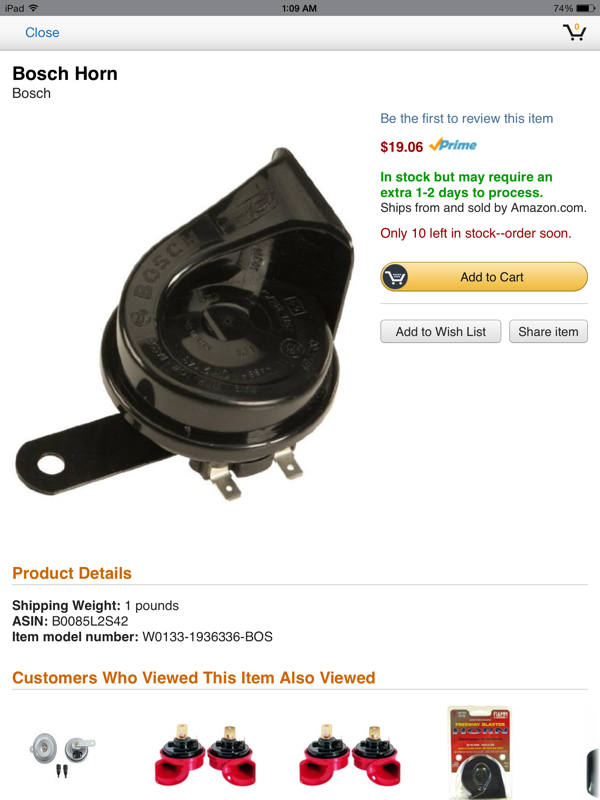

20 dlls, same part number, the plug is a little different so I'll have to splice the cables, but it's the exact same bosh part number low tone horn.

well, all done, got the horn from Amazon and it took 15 min to re install, all in all a 20 dll fix but an annoying repair, at least my car doesn't sound like the village idiot any more
