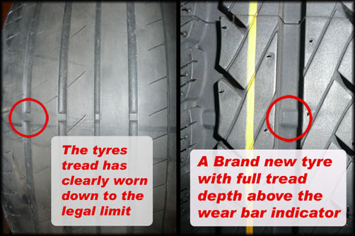

Here is what they are talking about
tread wear bars
