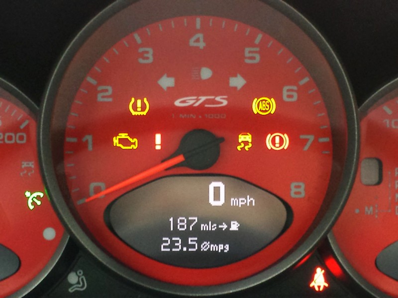

I replaced my gauge faces with the ones from FVD, couldn't be happier. I dealt with Rhonda and as most will say you can't find a better person to work with. I went with red for my GTS. Rhonda was able to get the GTS logo screened onto my tach. The fit and finish is perfect. FVD will also do the installation for you. I'd recommend that route. FVD has the tools and experience to do the job right. You do not want to break any of the stepper motor gears in the cluster.
Any pics?

Johnny, I'll post some pics later today.

Here's a few photos from my phone. Not the greatest but you'll get the idea.
Been thinking about red for my 2011 C4. this looks great!
