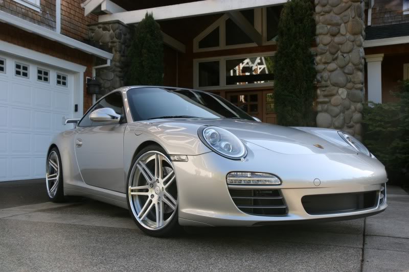

I also went with Eibach springs and am very happy. The drop is reasonable and the ride like stock...
Matt
Matt,
Your drop does look just right... It's not too much, and your car doesn't look "slammed."
Is your car PASM equipped?
Does your aerokit bumper lip scrape?

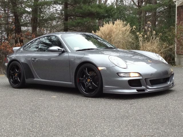

Originally Posted by Kustom64
You may also want to look into H&R lowering springs too
Here is my non-PASM C4 on H&R springs. I was completely disgusted with the huge fender gap that was there when I bought the car (non-PASM cars ride even higher up than PASM cars) I am completely happy with them and the ride height is perfect (and I installed these 3 years ago). I do think that the big factor will be whether or not you need to change out your shocks. The install is the big cost with springs - $1000 on average (labor alone). It will cost essentially the same in labor to change out to new coilovers...

Originally Posted by PSPorsche
Matt,
No PASM and yes the spoiler will scrape on steep driveways etc. I've used door edge guard to prevent damage. Sounds strange but if you search the forum you'll find a page about.
