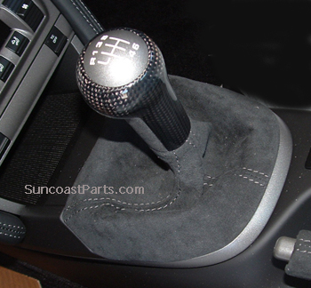

I would look for one of these...

That's what I figured. Still would really like a PDK however. I definitely plan on getting a car with a warranty.
If I find the right car, in the right condition, I won't rule out a manual trans.
