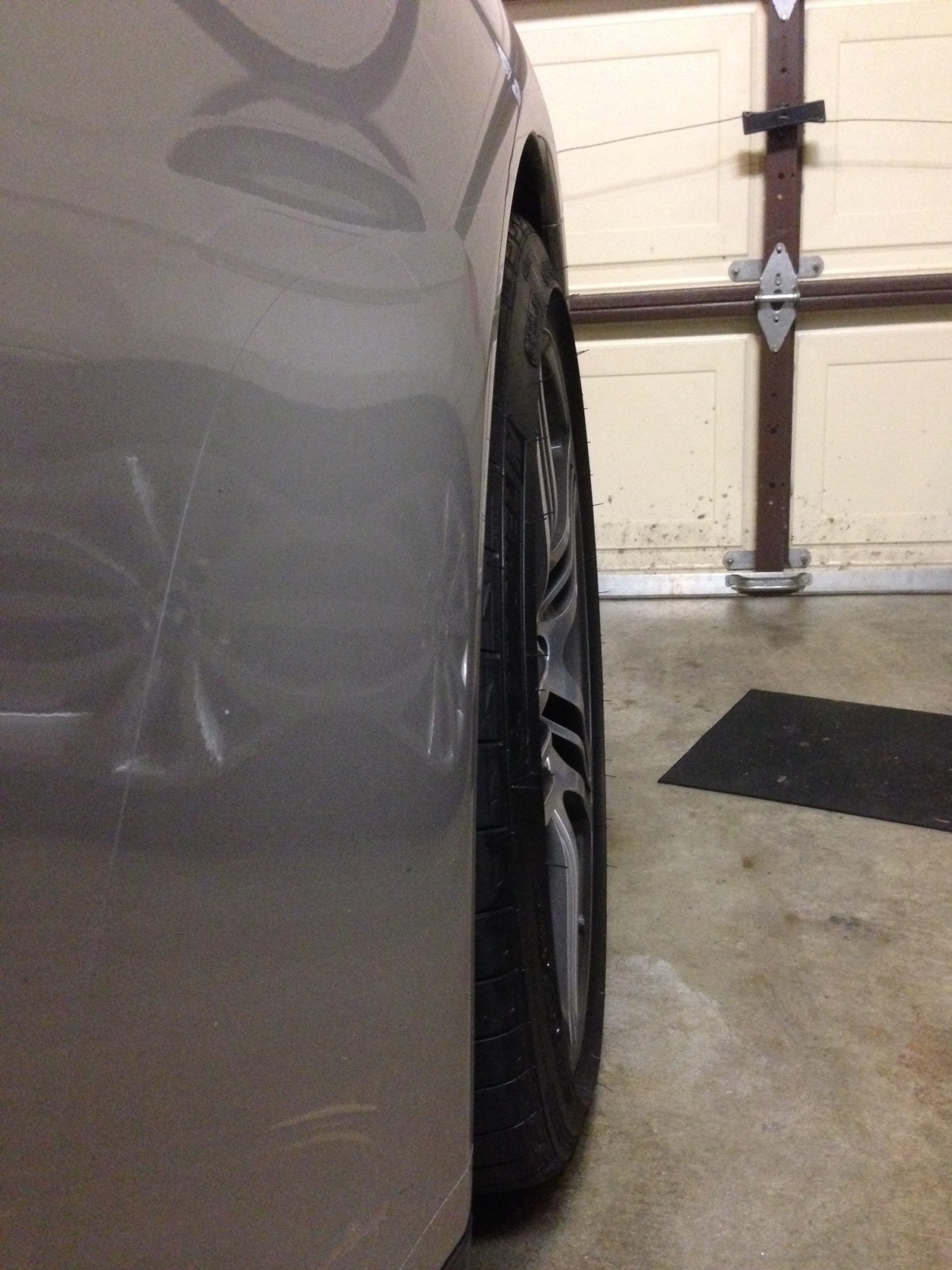

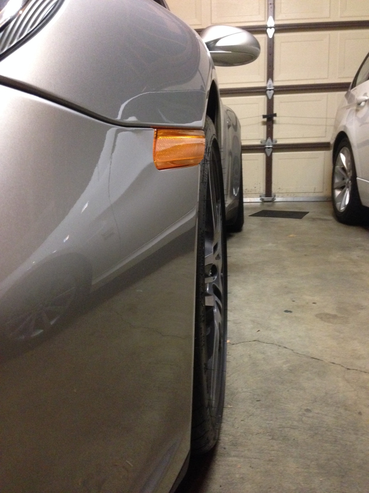

Here are the best shots I have that fairly show the difference when viewed from behind. You can see from the temp tags that it was one of the very first things I did (I had removed them from my trade-in and put them right back on the new car). To me, the inset on the first photo just appears wrong to me now that I've gotten so used to the more offset look. I don't think the offset looks radical at all, just better.
this is actually one of the best shots I've seen that outlines the difference between spacers or not, have you had any vibration at all because of the spacers? I've seen some earlier posts that outline the fact that you may get a vibration because the wheels aren't perfectly aligned.

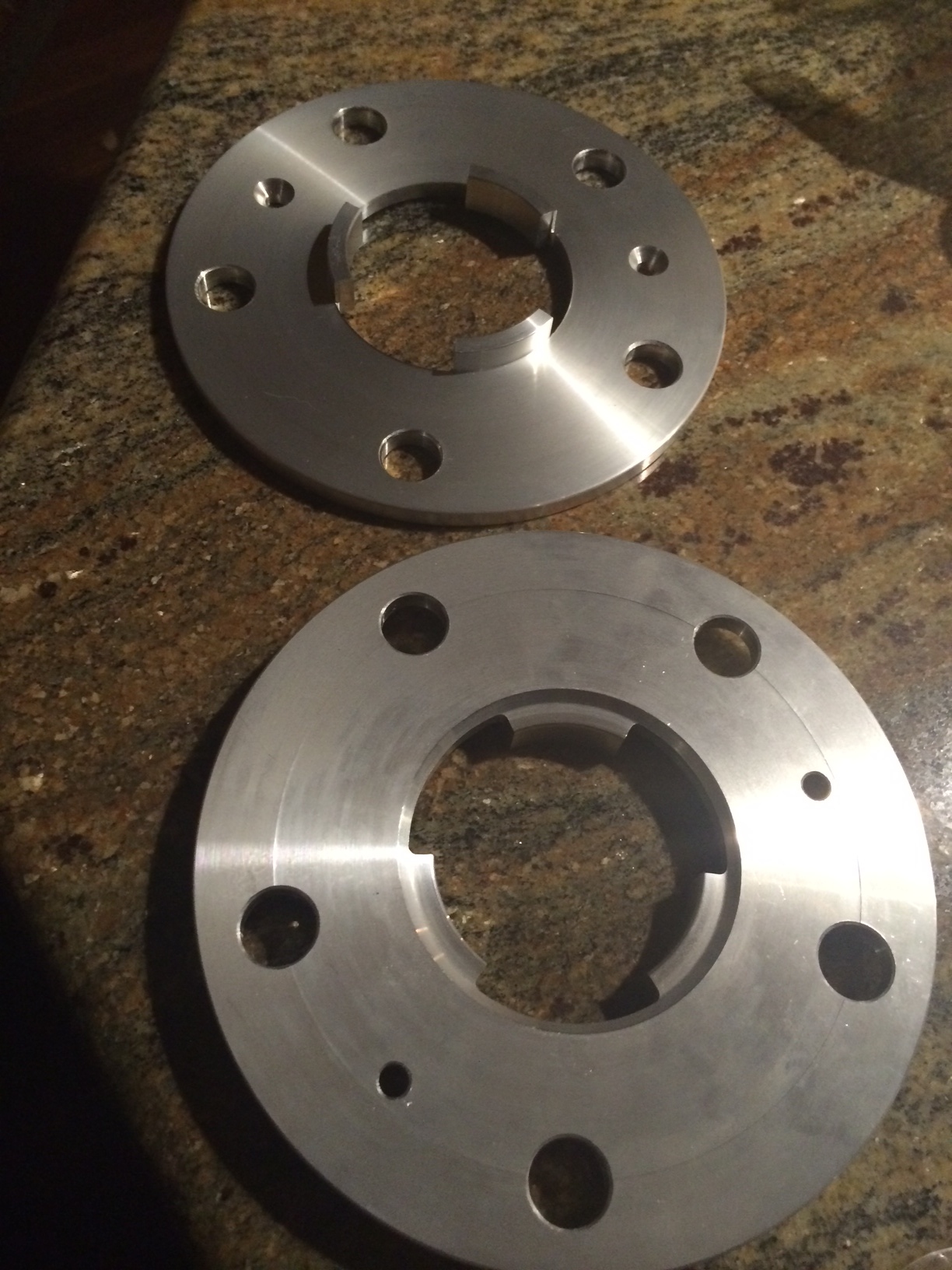

While some of the spacers on the market are simple flat discs, the ones I have from Adaptec (there are others as well) are now fully hub-centric and wheel-centric so there is no misalignment. This means that the spacer has an inset on the center than allows it to mate tightly aroiund the lip on the hub, and also provides another matching lip that juts out that allows the wheel to mate properly with the center of the spacer. Here is my front spacer turned both ways. You can see the mating inset and lip. The gaps align with the factory-created mating surfaces on the hub.

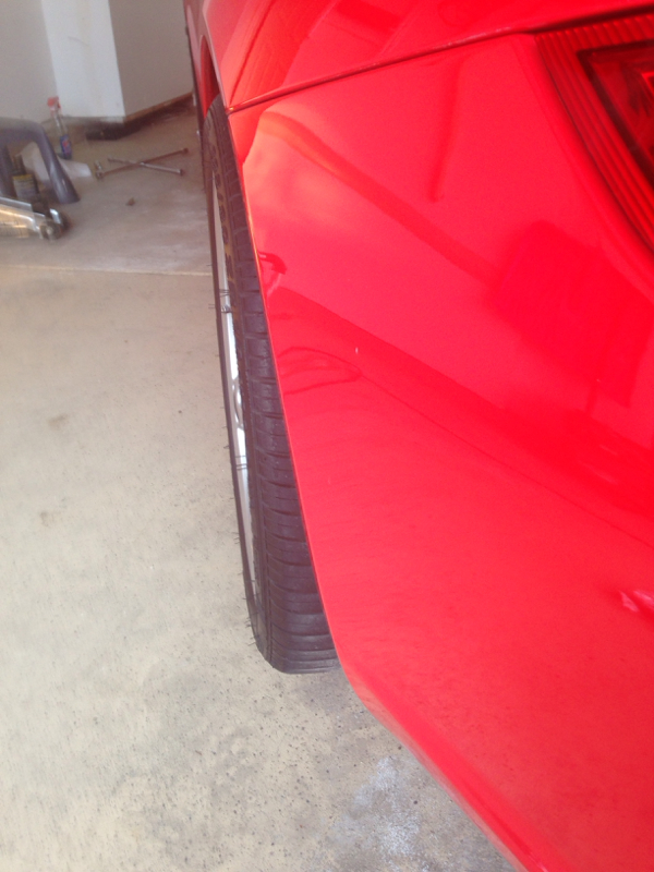

I have 2011 C4S and using Adaptec 10mm front and 18mm rear and they're a perfect fit
No issues with rubbing, rock chips, extra dirt, etc.

Can you post more pictures? I had 23mm on my narrow body and was always hoping to see anything more than 15mm on wide bodies.
Thanks

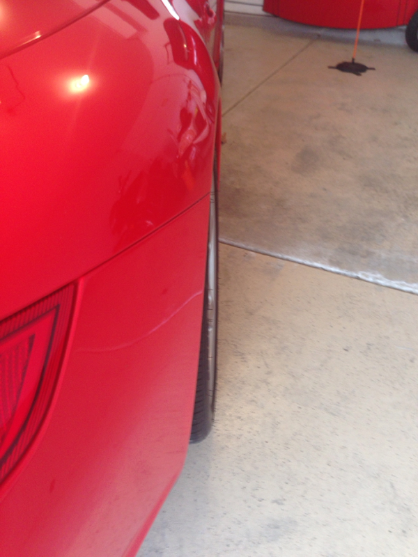

Finally made up mi mind and got the spacers
