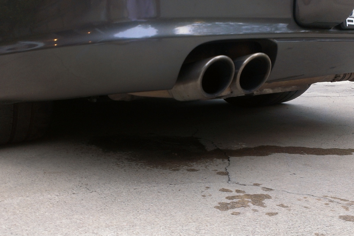

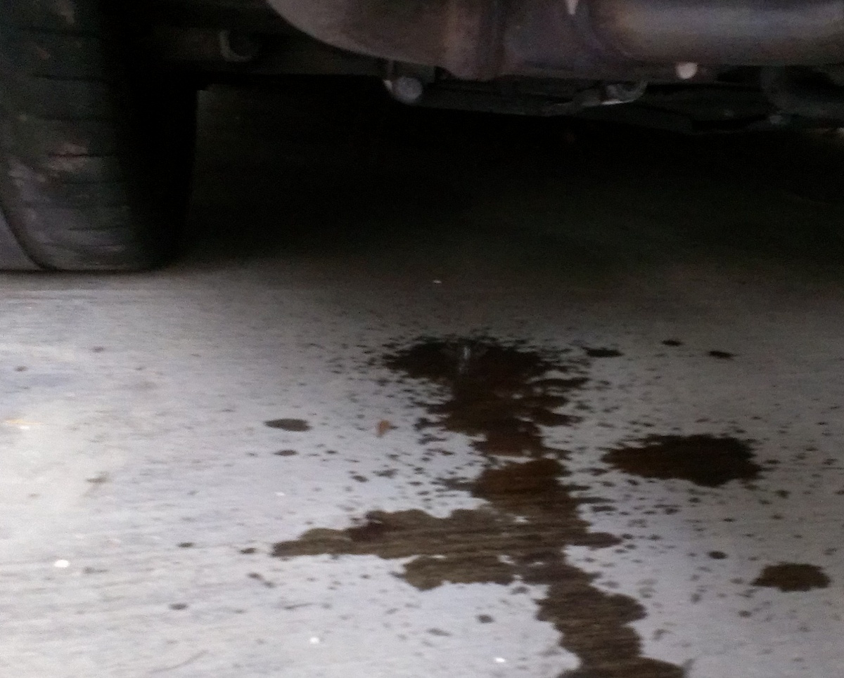

Just returned from an hour long drive through the canyons, and I noticed a water leak when I got home. The water pump was changed less than a year ago, so I don’t think it’s that.
Any input or thoughts would be greatly appreciated.

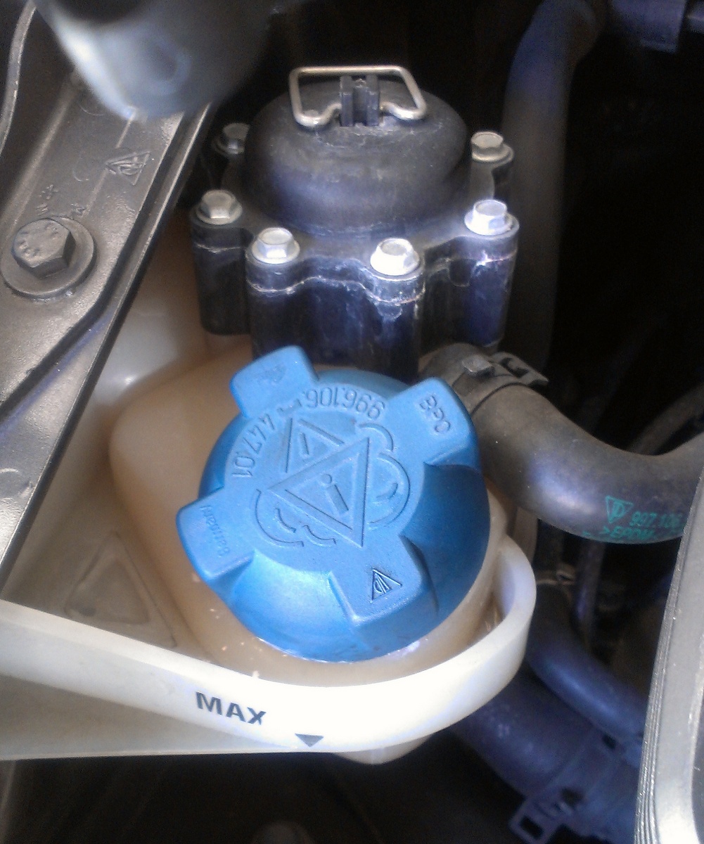

Check around the neck of the coolant tank and pressure relief valve for signs of coolant. Most probable cause is loose or defective cap. I would top up the tank using distiller water, if it's only down a quart or less, and replace the cap with the latest version.

Your spill is on the left rear. I had a similar problem, same location, same year car. Turned out to be a cracked overflow tank. It's plastic and tends to break where the hose connects to the tank with age.

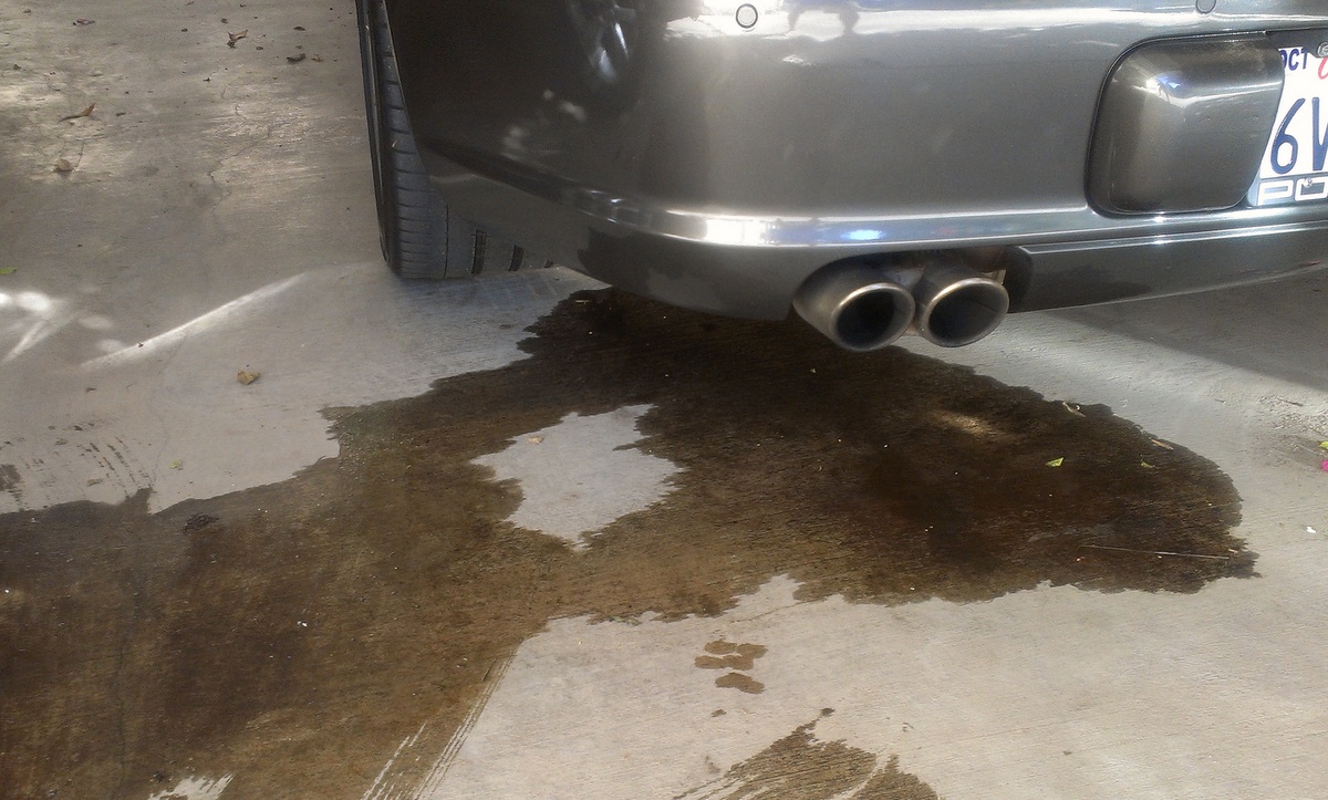

Great.... this is how it looks this morning. Would it be risky to drive 20 minutes to the mechanic?

Finally, it does appear to be the older cap (01) which was very easy to unscrew... is it wishful thinking to think this could be the problem? (That was a lot of coolant on the ground this morning).

It depends upon how much leaked out and how far the mechanic is. Top it off with distilled water to the max mark and let it sit with a cold engine. You are trying to estimate how much is leaking and how fast. In my case of the crack in the overflow tank, it would lose about 1-2 quarts overnight, dropping just below the min line but not emptying the overflow tank. Nothing more would leak out afterwards. But if it was filled it would drop to below the min line overnight again from this slow leak.I ended up topping it off and driving to the mechanic carefully watching engine temps to be certain it did not rise beyond normal.
If you are putting in a gallon or more to top it off each time the leak is different, have it towed. And don't despair, it could be something real simple like a loose hose clamp.

Just returned from the dealer/mechanic and it was diagnosed as a crack in the coolant tank. I want to thank everyone on the forum for the input, it was a great help.

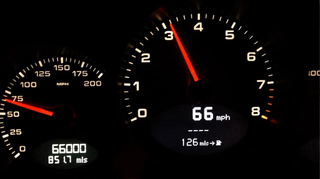

I'm curious what was your mileage (if you don't mind sharing) mine gave out around 57,600. That was back in November. Day after it was fixed I took her for a long drive up the coast with the local PCA group.
(mine's the seal gray one up front)
Anyway, she just turned 66k tonight on the way home.

The mileage just turned 61K......so maybe that's close to life expectancy for that part.
